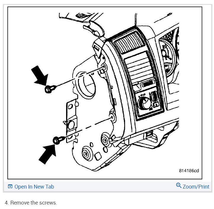

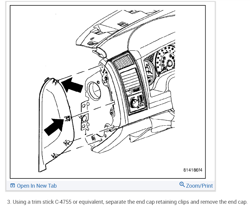

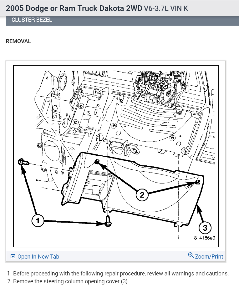

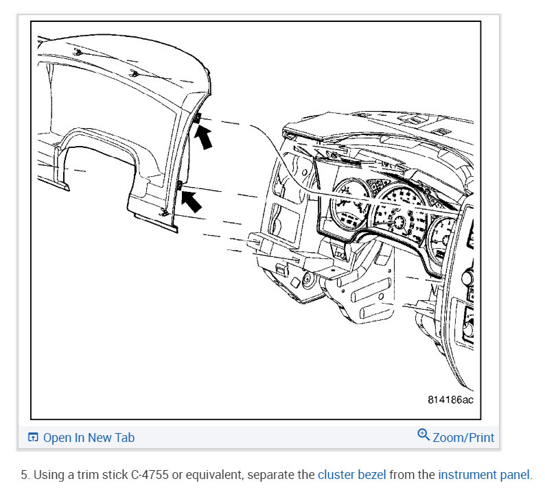

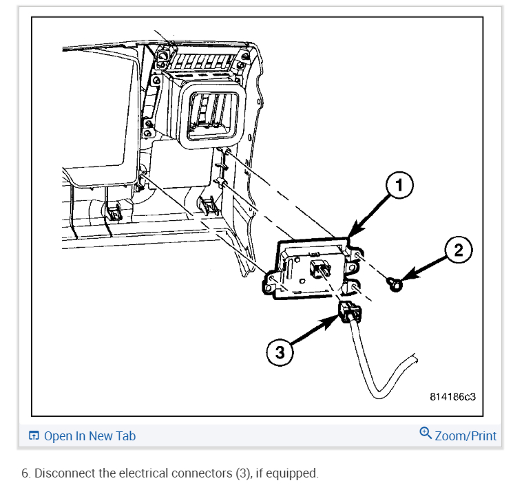

This happens when the cluster goes out which holds the mileage value. I would get a rebuilt or used unit here is a video of the job being done on a similar car with diagrams below to help you with your car.
https://youtu.be/_HEC44xENxw
Check out the diagrams (Below). Please let us know what happens.
