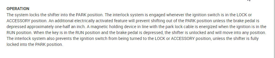

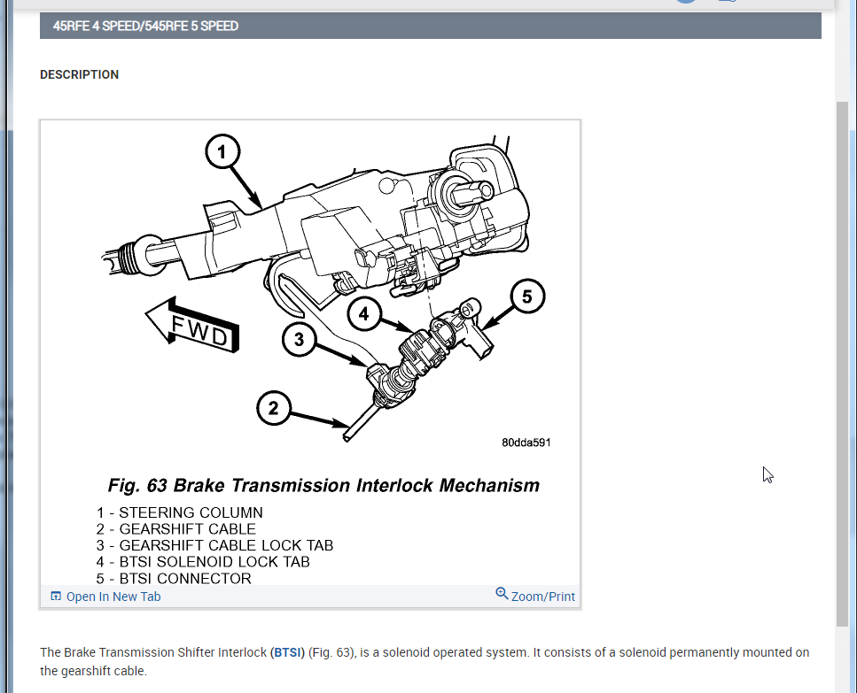

Are you able to move the shifter? If not, do your brake lights work? I know that sounds like a spupid question, but the brake light switch send a signal to the park interlock system allowing you to shift when your foot is on the brake.

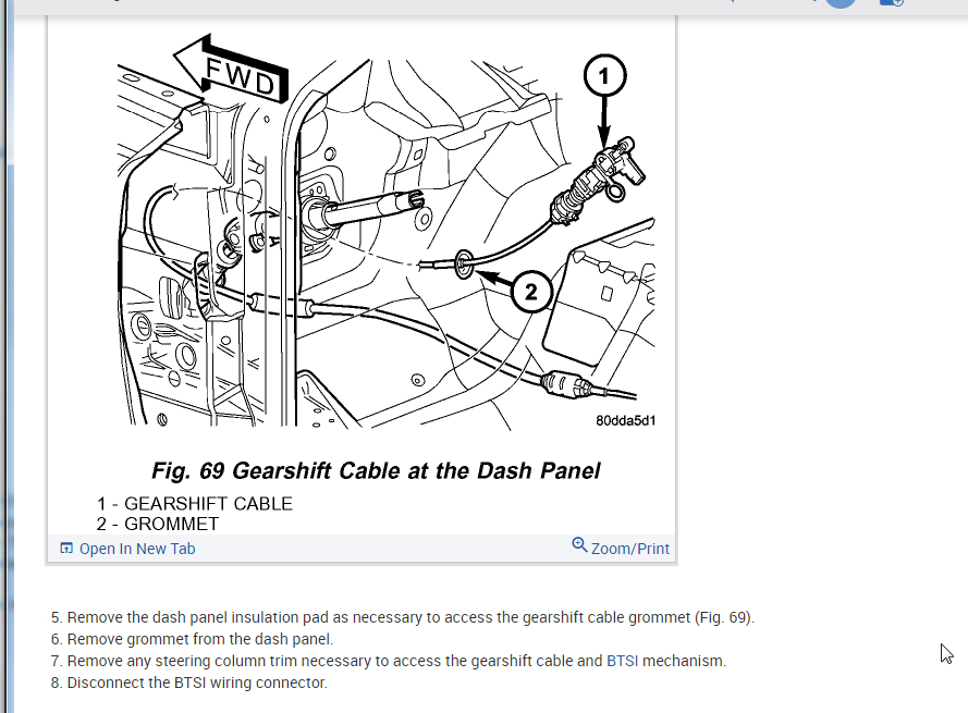

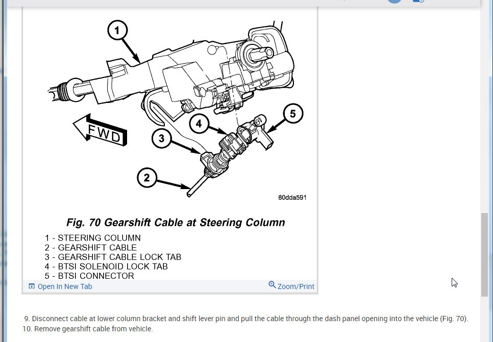

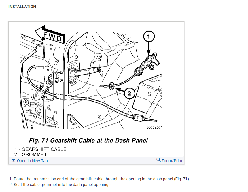

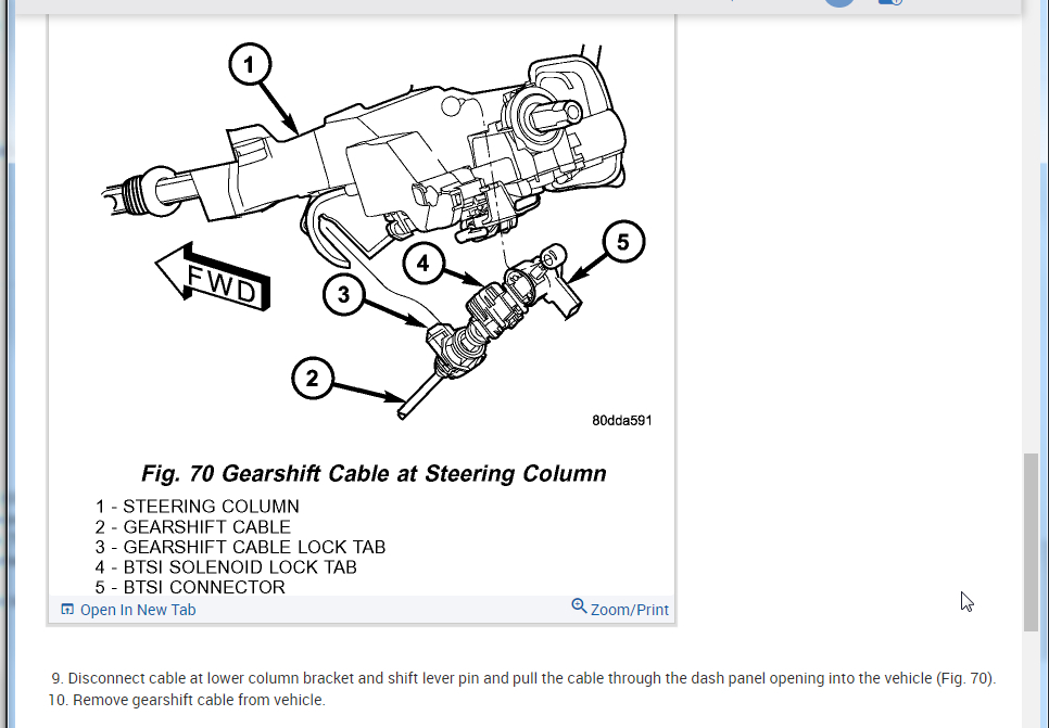

Hi I'm having the same problum will not shift put of park most of the time. But this time I was a little pissed off and pulled a little harder and now I can freely move my shifter but it don't move out of park. I replaced the trany no more then 4 months ago Had no problums till this eny ideas.
Dec 17, 2016 at 12:12 AM

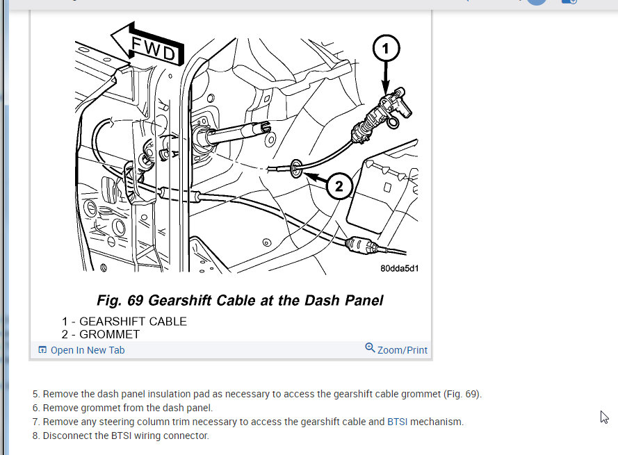

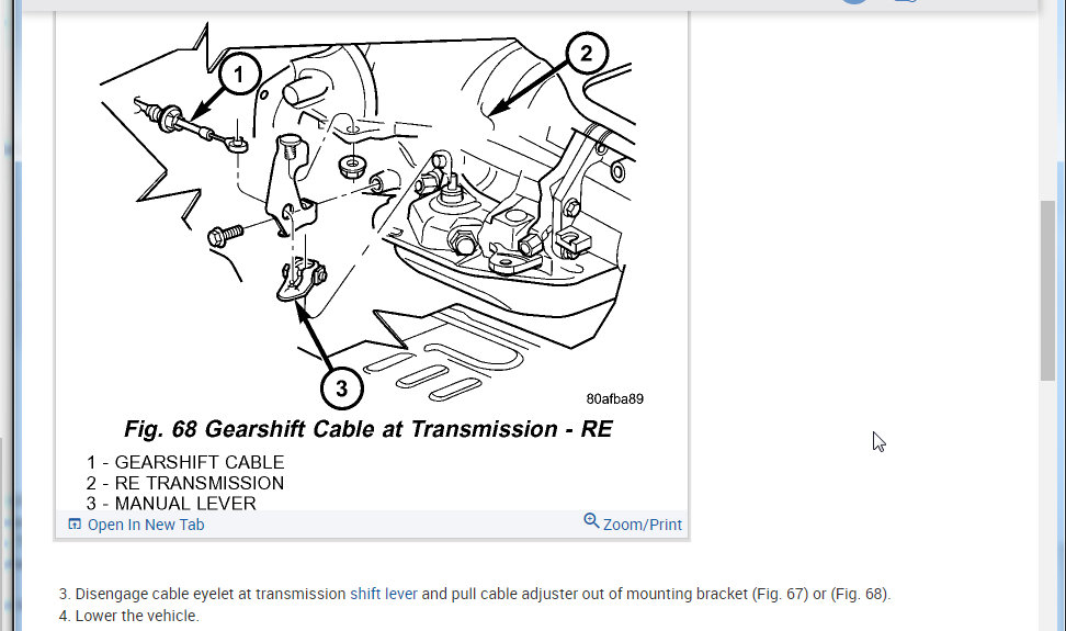

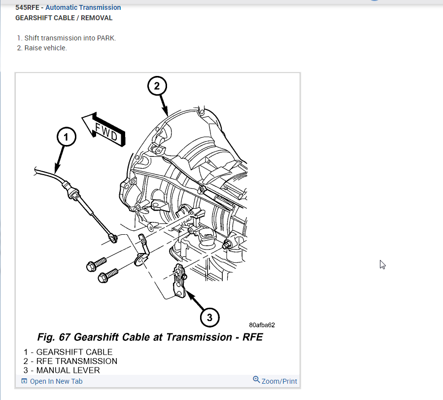

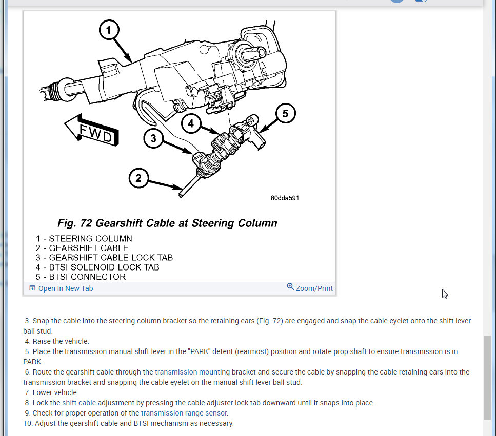

I suspect you have two issues now. First was the interlock was not releasing which is why you could not shift out of park. However, now the cable is most likely broken or come off the transmission.
So I would just make plans to replace the cable with the attached process but you can start with inspecting it and just make sure it is broken or if it is unattached.
Let us know if you need more info. Thanks
