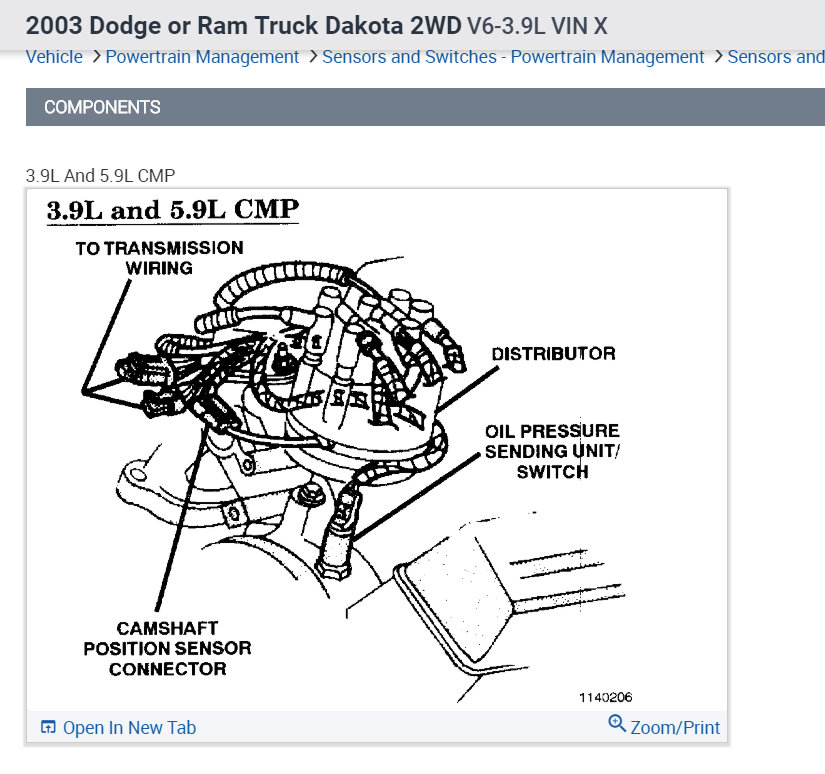

Welcome, 3.9L engine, should be in the distributor. Check out the diagrams (Below). Please let us know if you need anything else to get the problem fixed.
Image (Click to enlarge)

Where are the crankshaft position sensor and the camshaft position sensor located on my 1995 Dodge Dakota Automatic 6 cylinder?

Crank sensor is in the transmission bell housing right behind the right cylinder head. Cam sensor is in the distributor.

cam sensor assuming its a 4.7 is on the passenger side of the engine, towards the front and top of the cylinder head.... crank sensor is also on the passenger side of the engine located just under the exaust manifold closest to the rear of the engine, just under a freeze plug...
