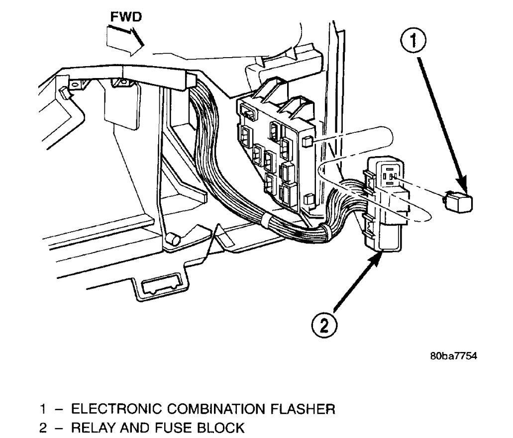

Where is the turn signal flasher located on my truck
Sep 6, 2009 at 12:11 PM
JDL
  • 16,098 POSTS
There are two locations, Look on the left end of instrument panel, you may have to open the door. See the diagrams below for location
