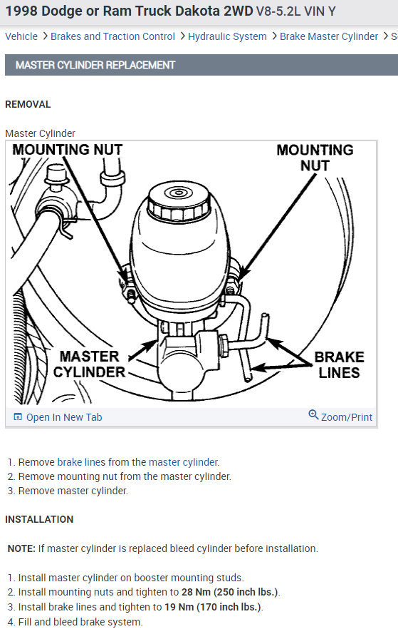

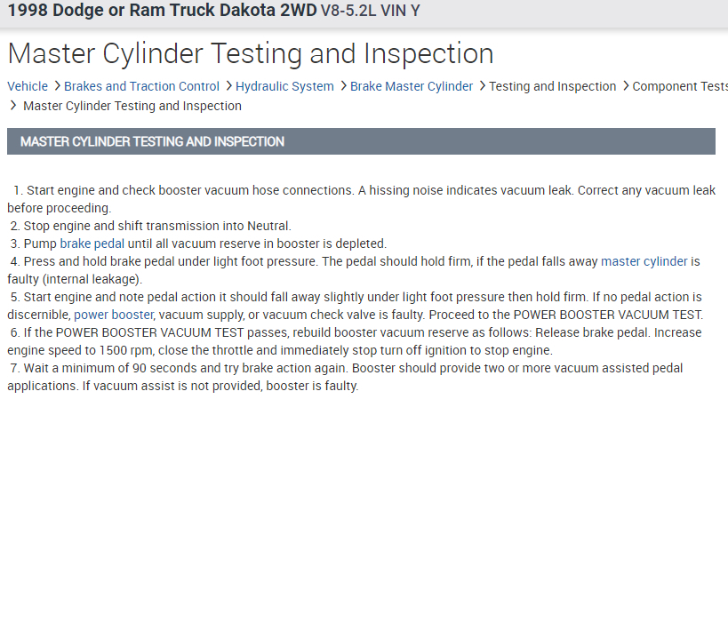

It sounds like you might have a faulty brake master cylinder.
When a master cylinder unable to build pressure, the brake pedal will go to the floor. Sometimes you can pump it up for momentarily before loosing brake pressure again.
This usually happens when the seals inside of the master cylinder blows out.

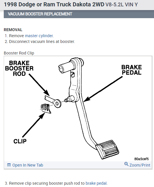

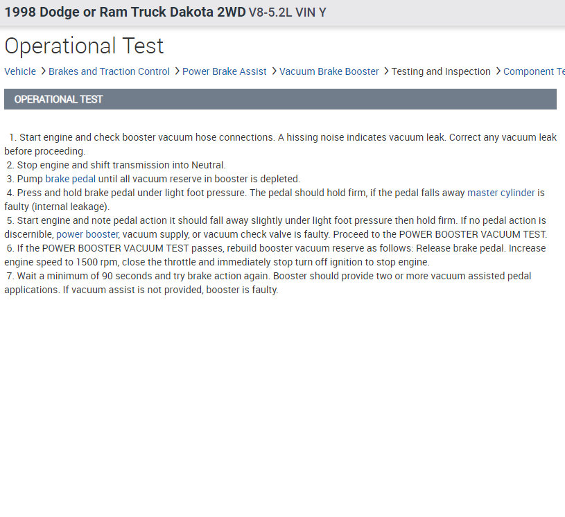

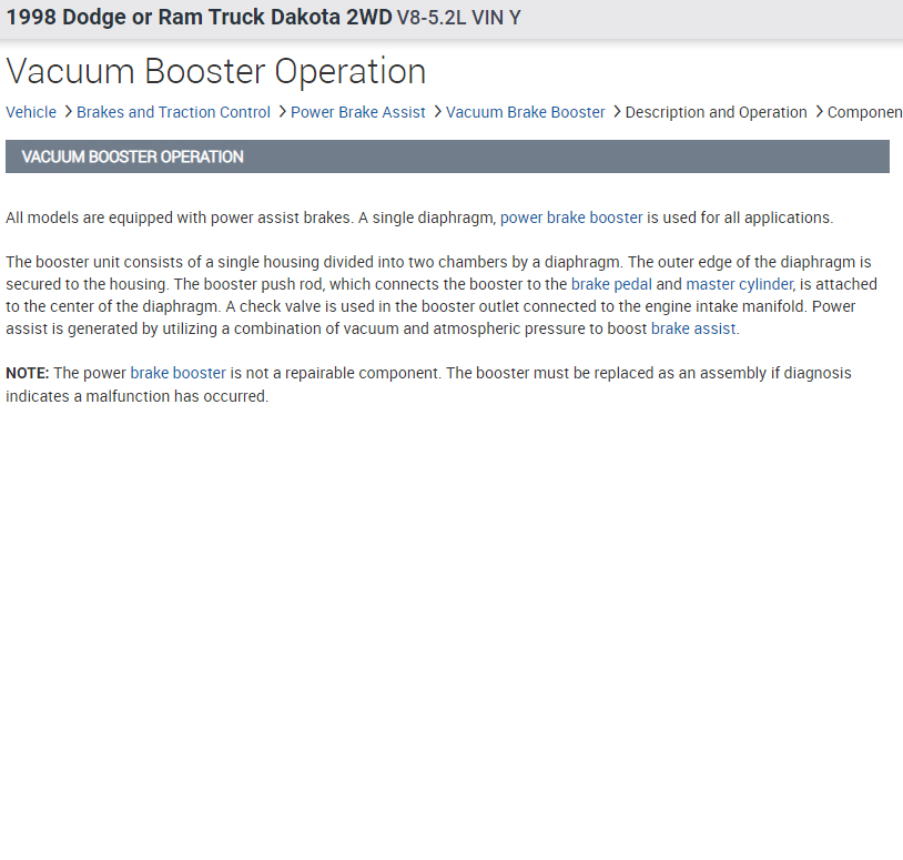

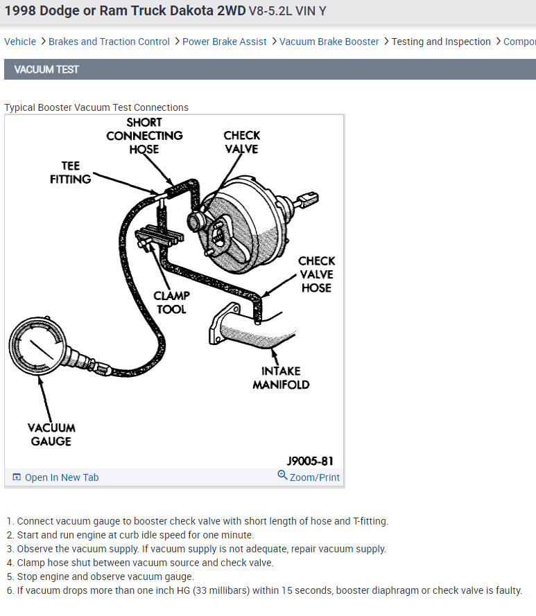

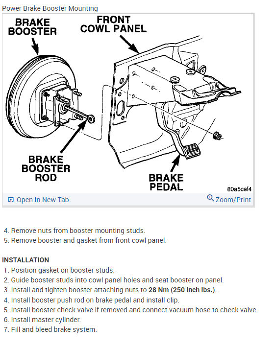

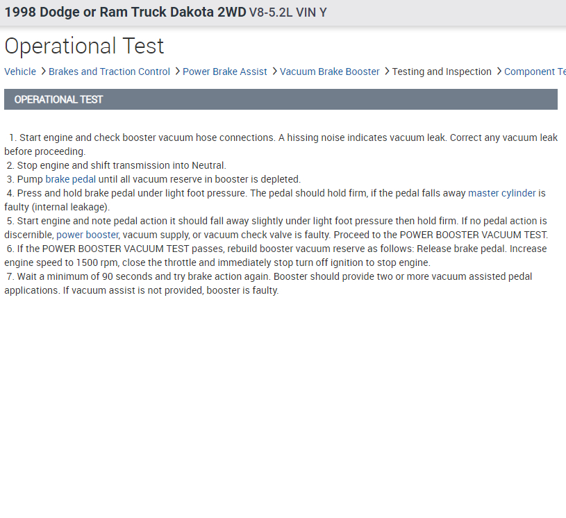

Another item you need to check is the brake booster. If the vacuum assisted booster have issue it can trigger similar symptom.
Make sure that the vacuum gauge is connected securely to the booster.
You can also test the booster by using a vacuum gauge (see diagram).
If you were to change out the master cylinder, be sure to bleed the brake system afterwards.
https://www.2carpros.com/articles/how-to-replace-a-brake-master-cylinder
I have attached the diagrams for your reference.
