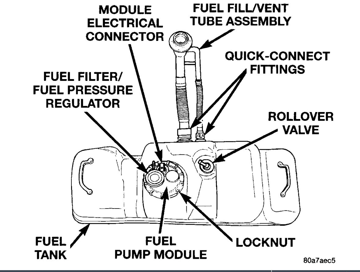

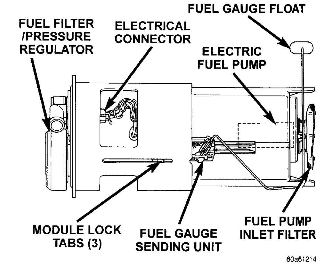

Your fuel level sensor (Tank Unit) is shorting out, replace it to repair this problem. Please get back to me when the repair has been made.
See the pictures below for location
