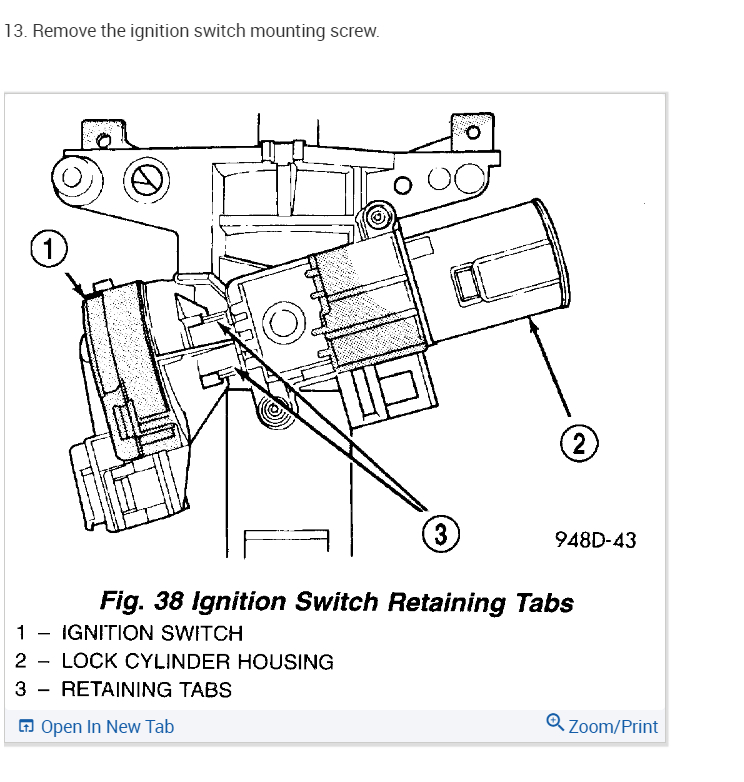

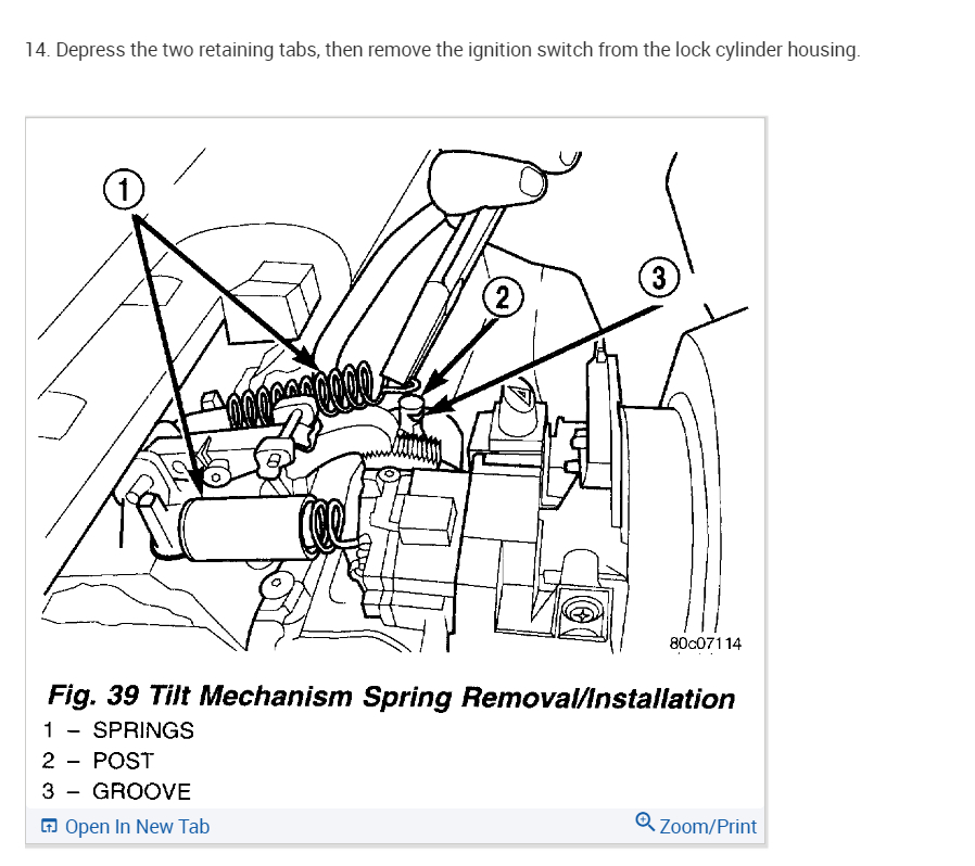

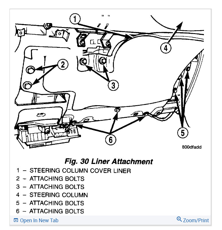

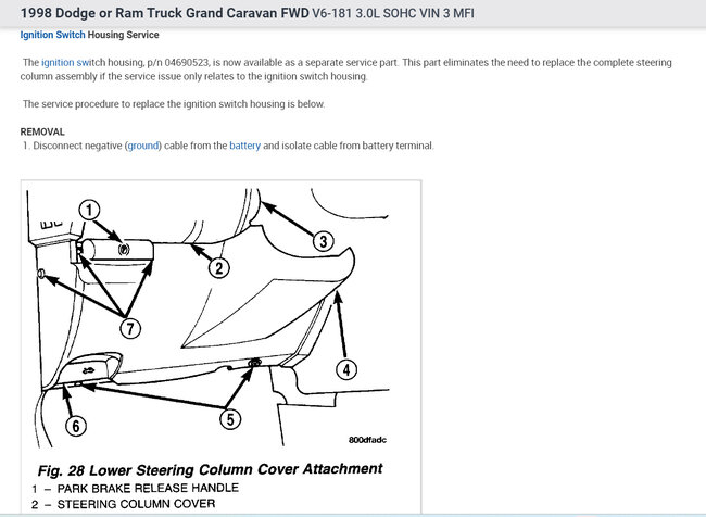

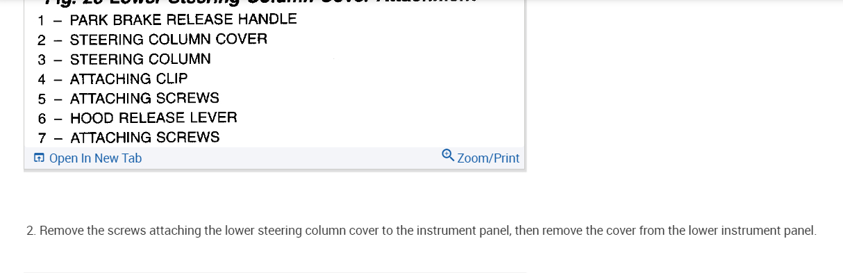

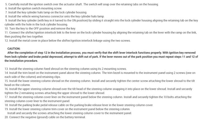

Dec 8, 2022 at 5:17 PM

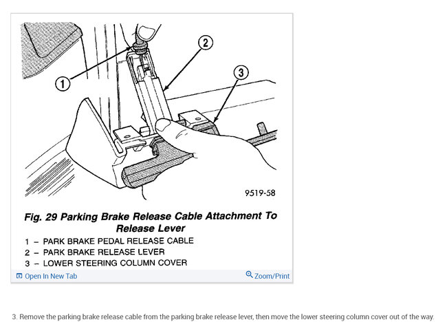

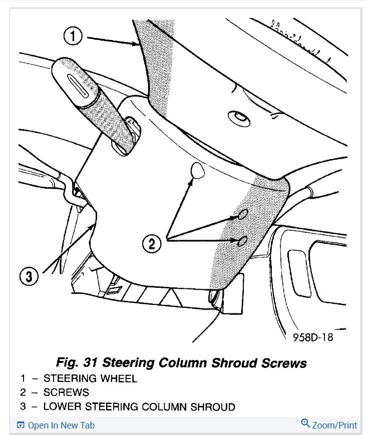

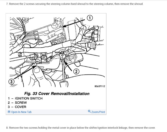

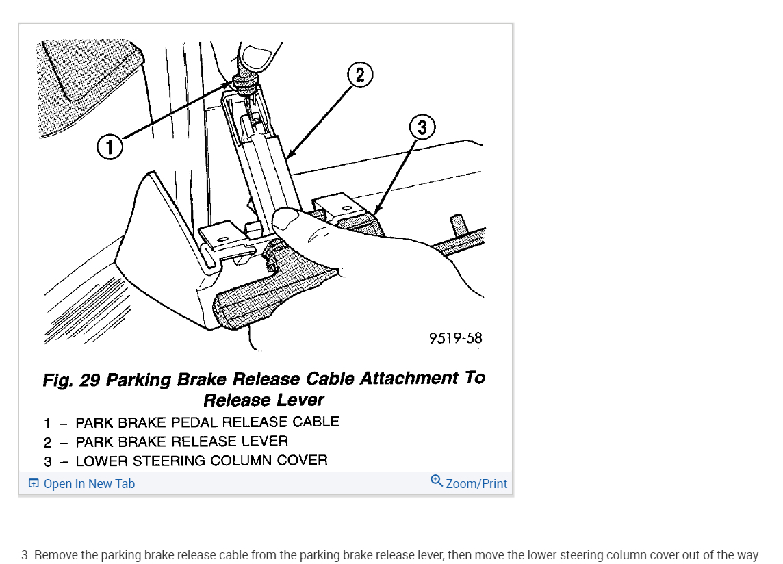

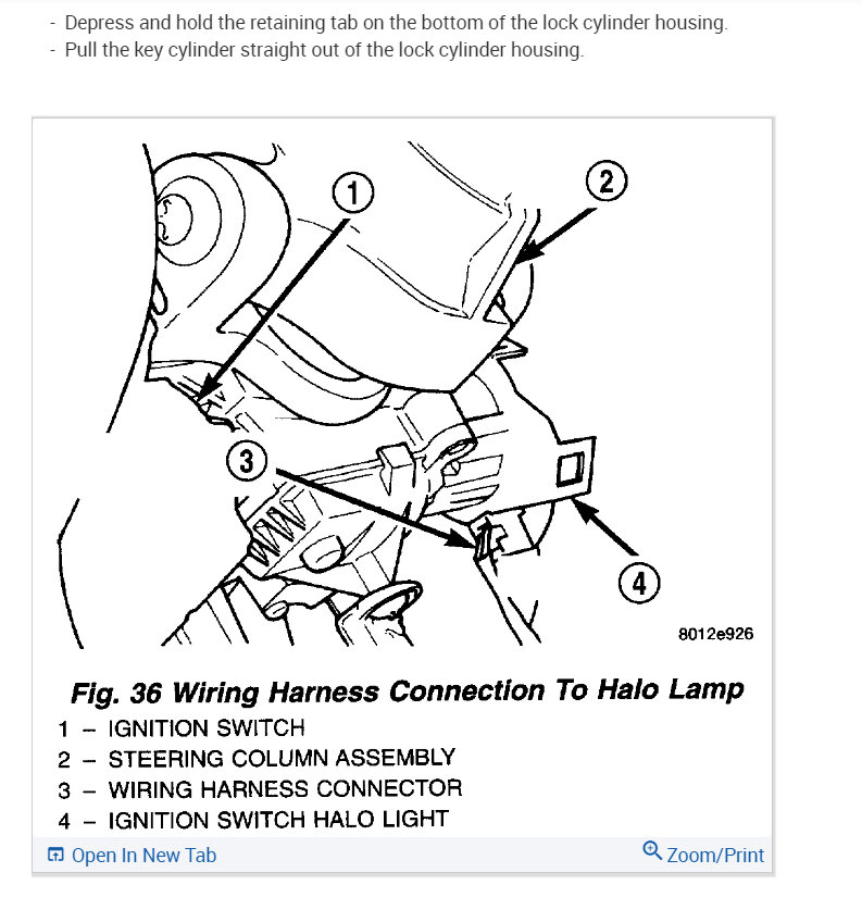

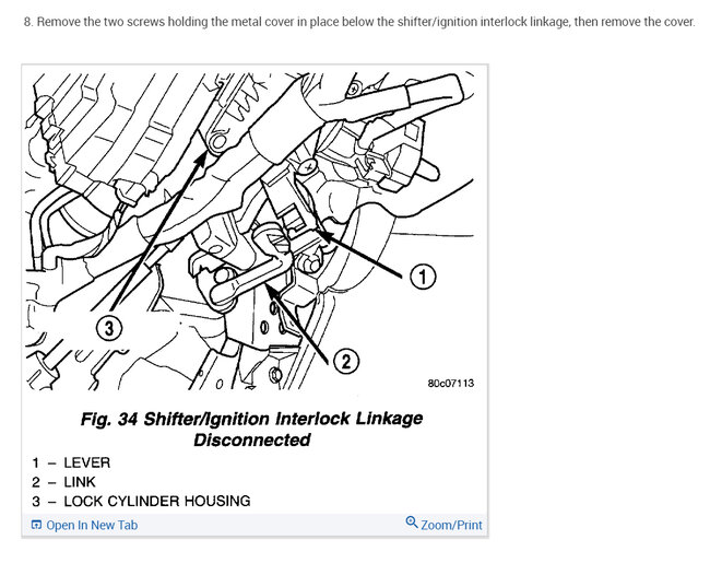

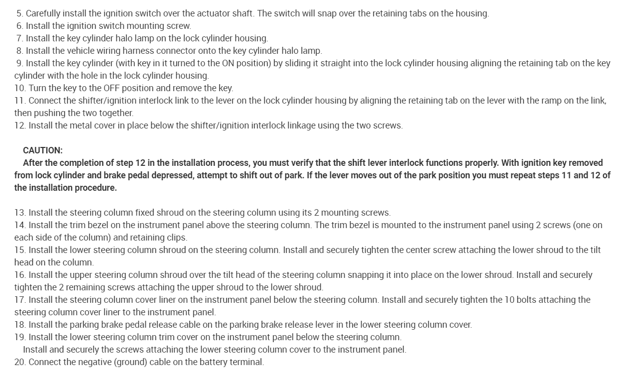

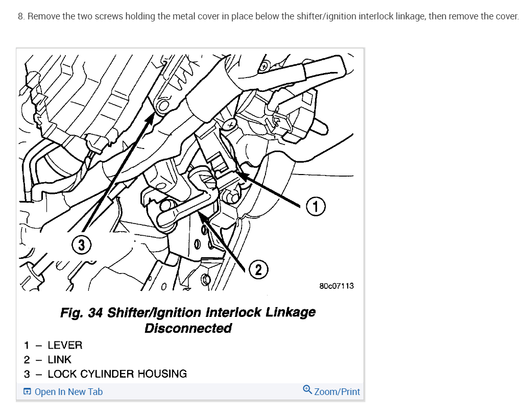

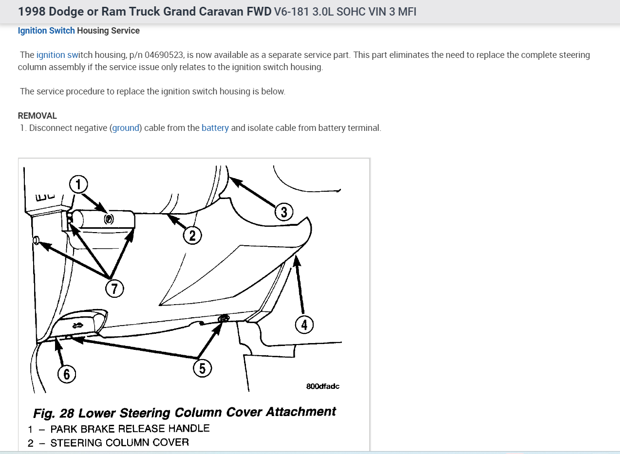

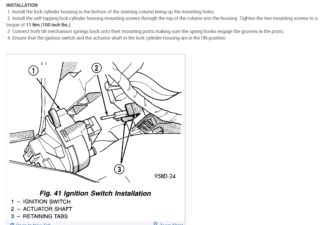

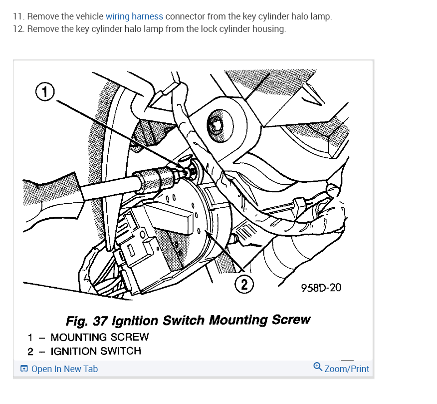

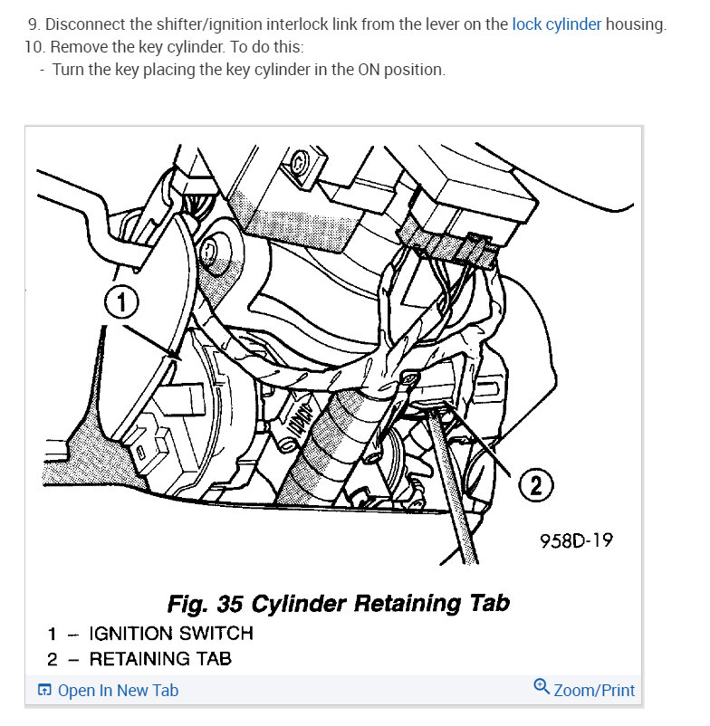

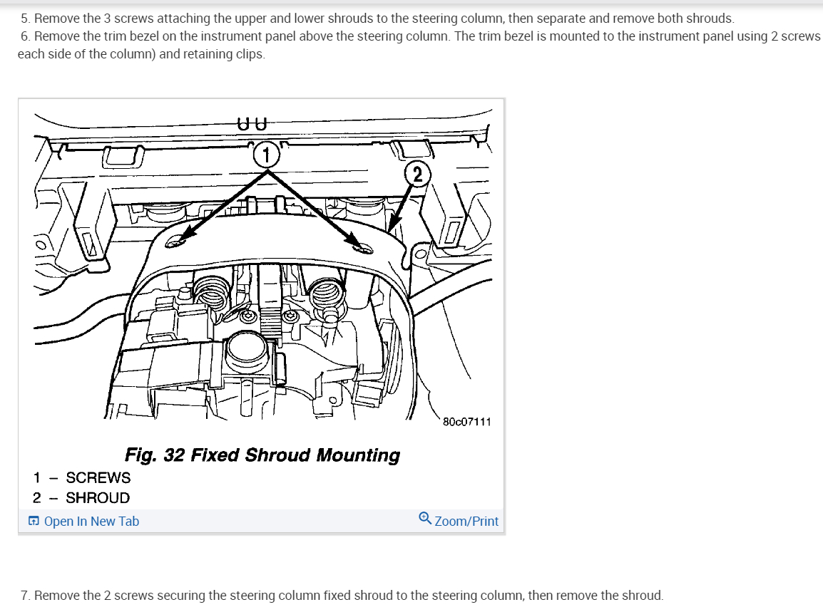

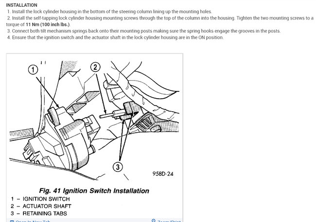

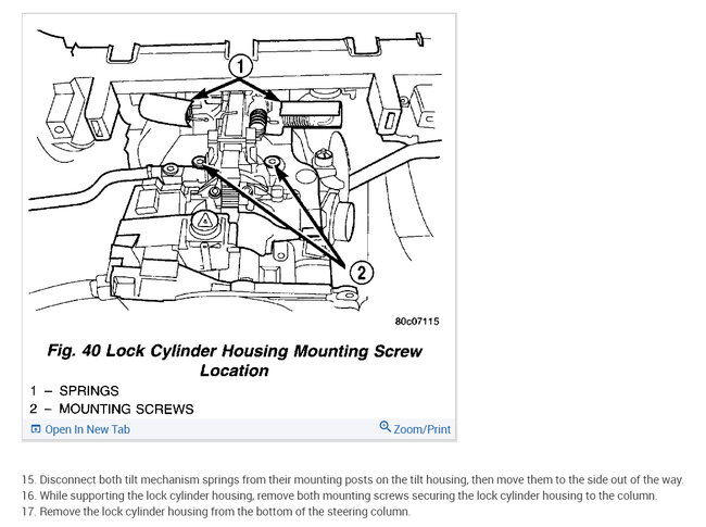

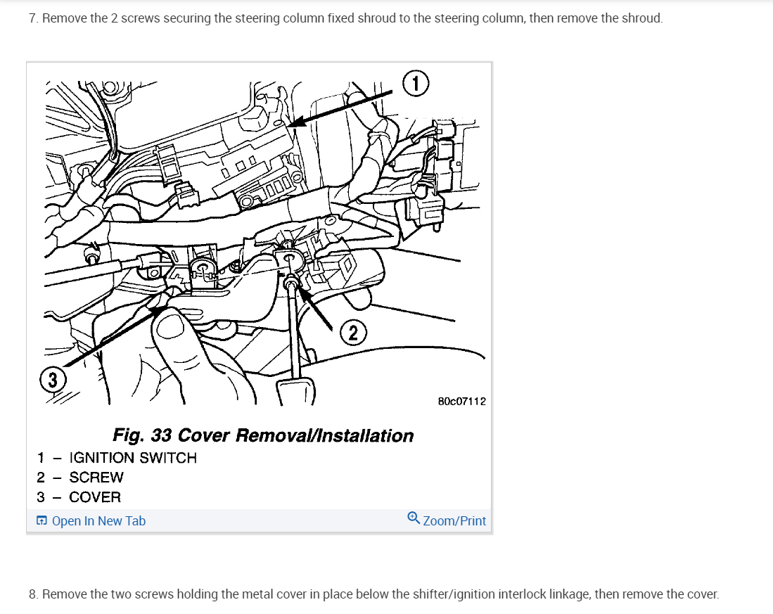

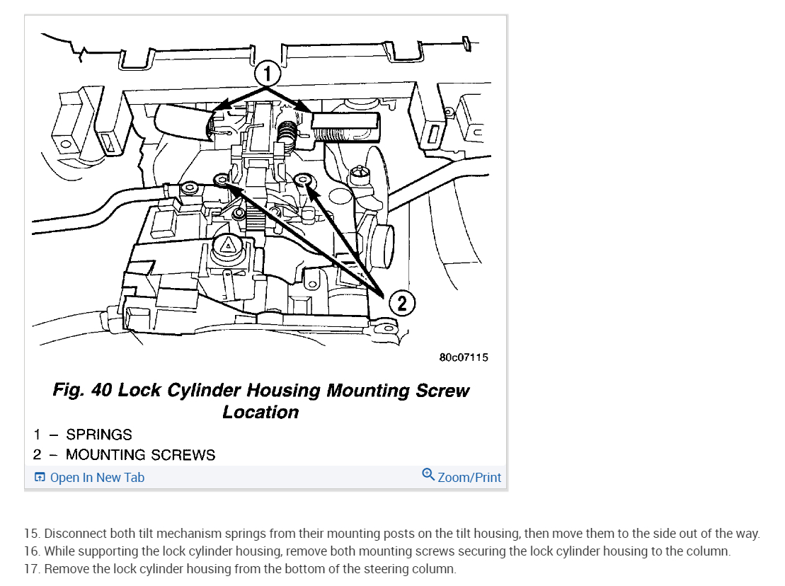

What happens is the lock becomes worn and allows the locking pin not to be fully engaged. Here are the instructions on how to change the lock out. Check out the images (below). Please let us know if you need anything else to get the problem fixed.
