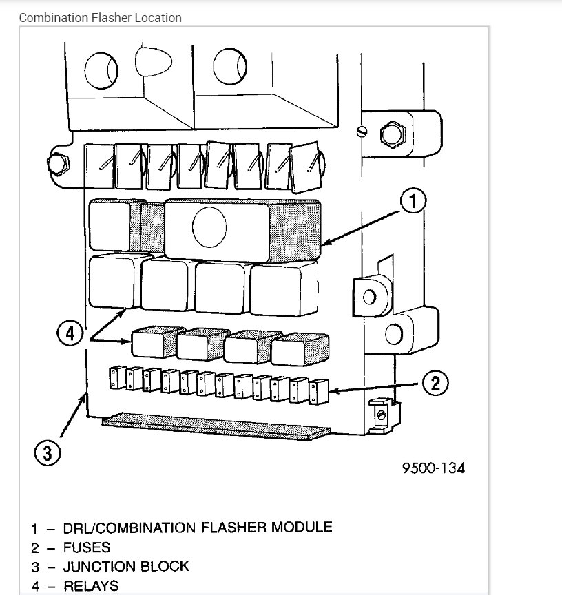

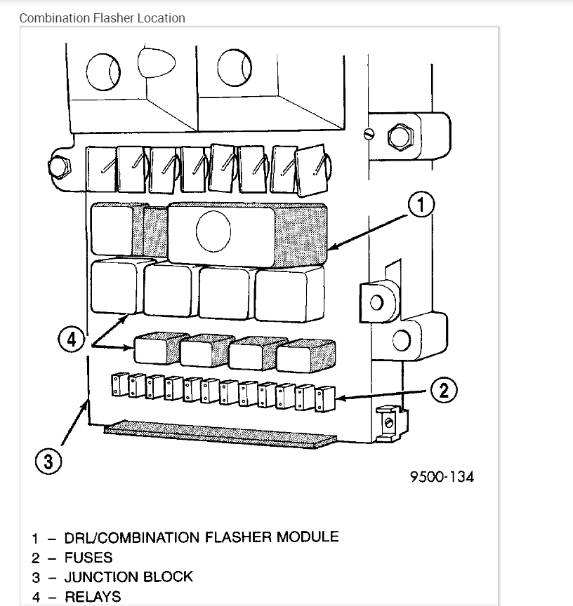

Do the emergency flashers seem to work? Sometimes when you cycle the switch the blinkers will start working. If not replace the turn signal flasher module, here is the location in the diagrams below. Check out the images (Below). Please let us know what happens.
