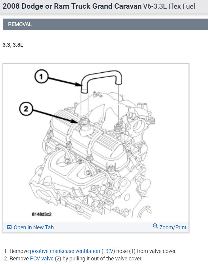

Where is the PCV Valve located on the 3.8L engine?

https://www.2carpros.com/forum/automotive_pictures/55316_03caravanpcv_1.jpg
Aug 17, 2019 at 4:37 PM (Merged)
RONSON
  • 77 POSTS
I failed smog because of a cracked PCV hose. Where is this hose located?

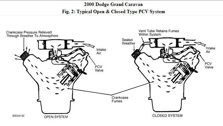

most likely, the pcv snaps into a valve cover as in most vehicles
i did look thru "mitchell i" for about 30 minutes. below is the only diagram i could find on "pcv" for your rig
if you are still lost---take a pic of both sides of your engine---maybe i can identify it for you that way easier than that! a parts store should be able to point it out for you in person!

the hose should run to the PCV valve on the valve cover.
RONSON
  • 77 POSTS
Well I figred the same thing. I will have to take a look at the rear cover because it's not in the front. Thanks for your time.
