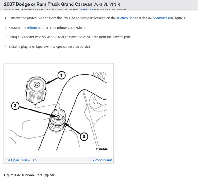

I am trying to locate the recharging (low pressure) port for my A/C. I found what I believe to be the high pressure one which is on the smaller diameter line and is too big for my connector. The low lines along the firewall and back side of the engine do not seem to have any port at all. I can't find it.... help?
May 26, 2010 at 2:03 PM
RASMATAZ
  • 75,992 POSTS

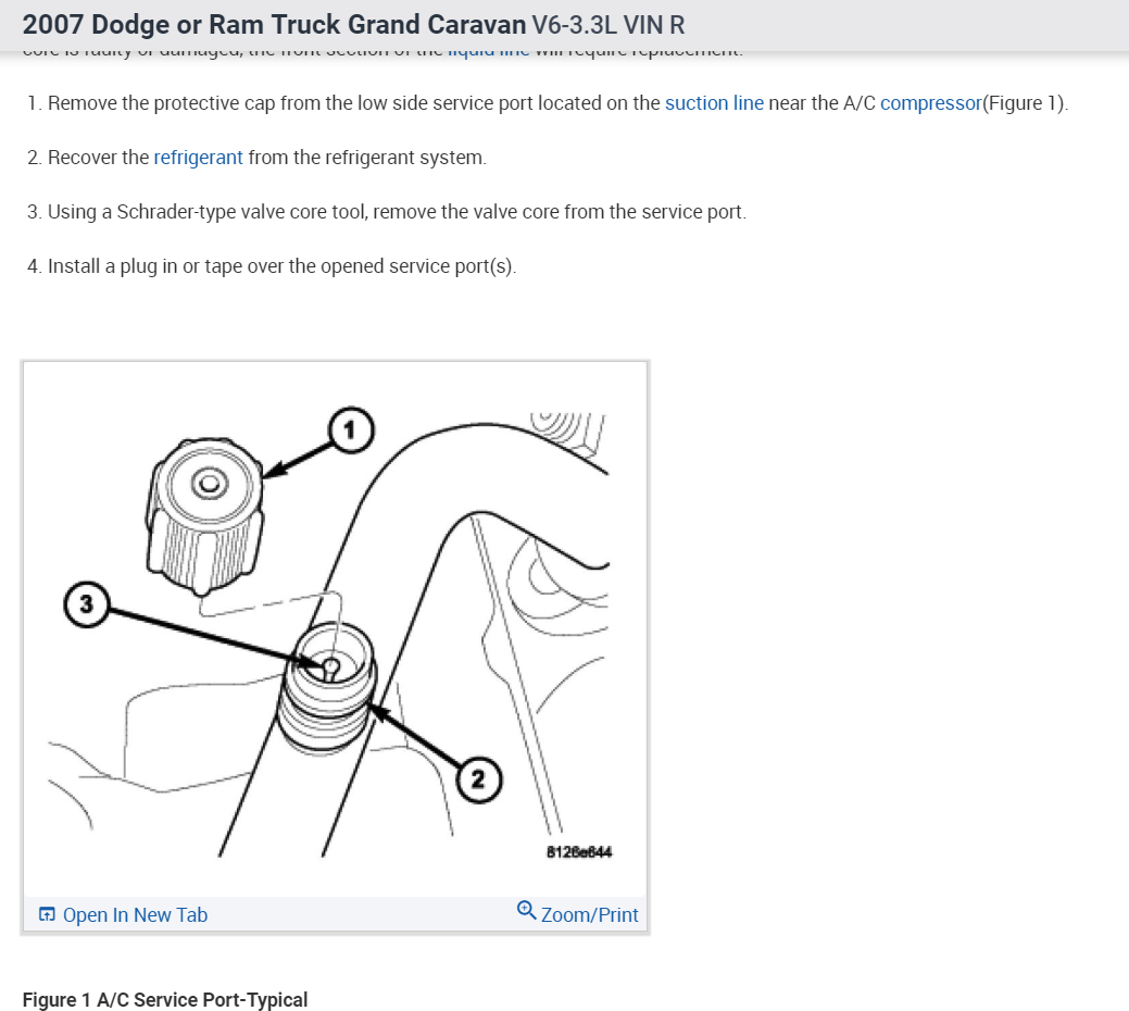

The low side port is on the low side hose near the firewall here is a video to help you find the post with diagrams below to show you on your car.
https://youtu.be/ON2dYcmXIAw
and
https://www.2carpros.com/articles/air-conditioner-how-to-add-freon
