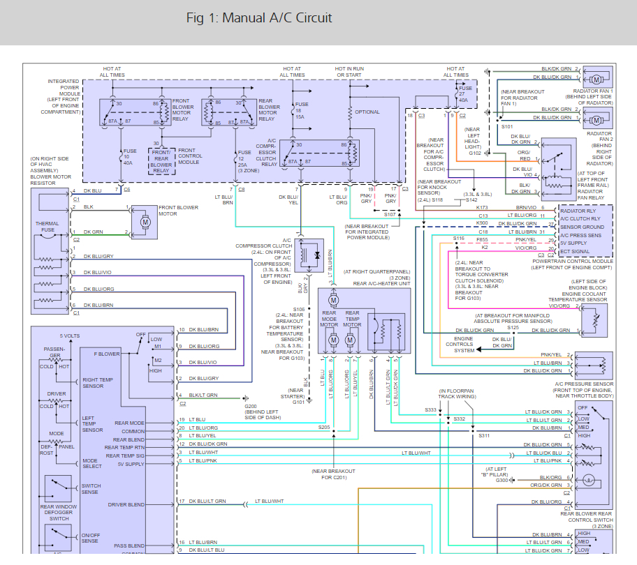

My front AC blower does not work. I removed it and applied 12v power directly to it and it worked fine. The rear blower does operate correctly. I did a little online research and was advised to change the resistor (part# 4885583AC). Superceeded by: (68029175AA $14.49 - Hvac - Controls - Blower motor - Resistor) Any suggestions????

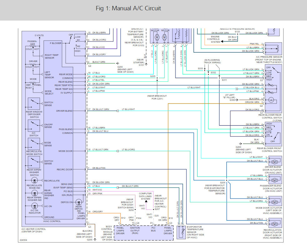

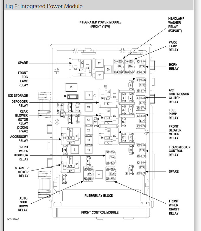

This can be the blower motor relay or the speed controller. Here is a guide to help you test the relay and a wiring diagram to show you how it works and the location of the blower motor and relay as well.
Check out the diagrams (Below). Please let us know what you find. We are interested to see what it is.

I said that I applied direct power to the blower motor and it worked. Meaning.... I pulled the blower out and connected 12v battery power directly to the connections on the motor. When the blower motor is installed in the vehicle I do not get a response from any of the different fan speed settings on the A/C climate control panel.

I read and understood your post. You hot wired the motor. I want to know if power is getting to the motor.
Was the fuse replaced?
Check out this guide it shows how to test for power and ground
https://www.2carpros.com/articles/blower-fan-motor-works-on-high-speed-only
These are all causes for the motor to not operate:
Front control module (FCM) DTC(S) present
IPM fuse #10
Fused front blower motor relay output circuit shorted to ground
Front blower motor resistor block shorted to ground
Blower motor
Blower motor
A/C - heater control module
Ground circuit open
Blower motor high driver circuit open
Front blower motor resistor block open
PDC-open circuit
PDC-open circuit
Front blower motor relay
PDC-open circuit
Fused front blower motor relay output circuit open
This particular chysler product does not have the power separate for high speed, that was my mistake.

and the relay at the IPM box I figured that the motor was shot. The rear blower works fine.
