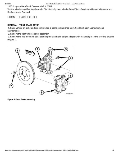

Can you help me save money by showing me how to do the front brakes?

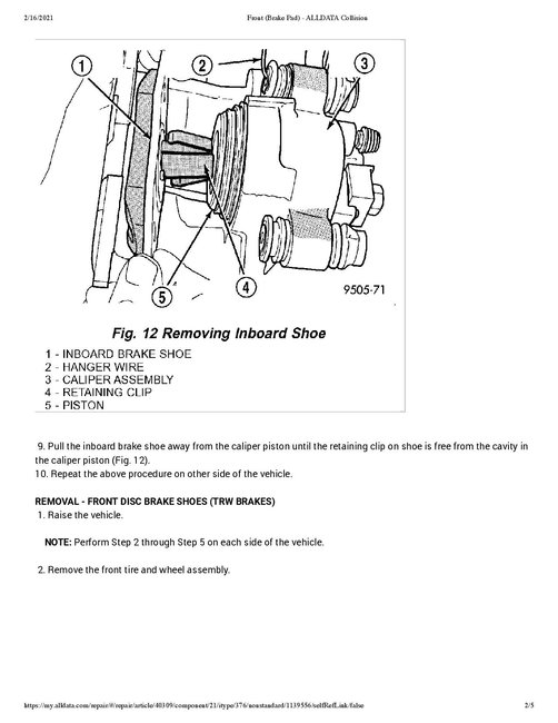

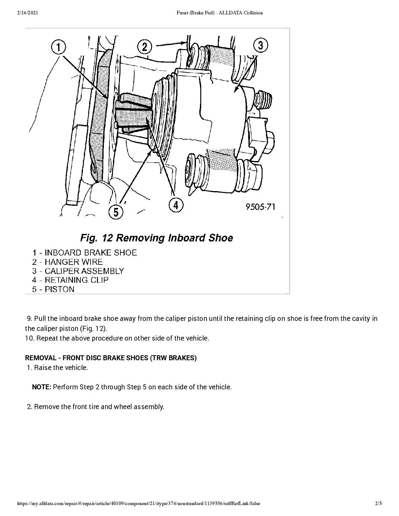

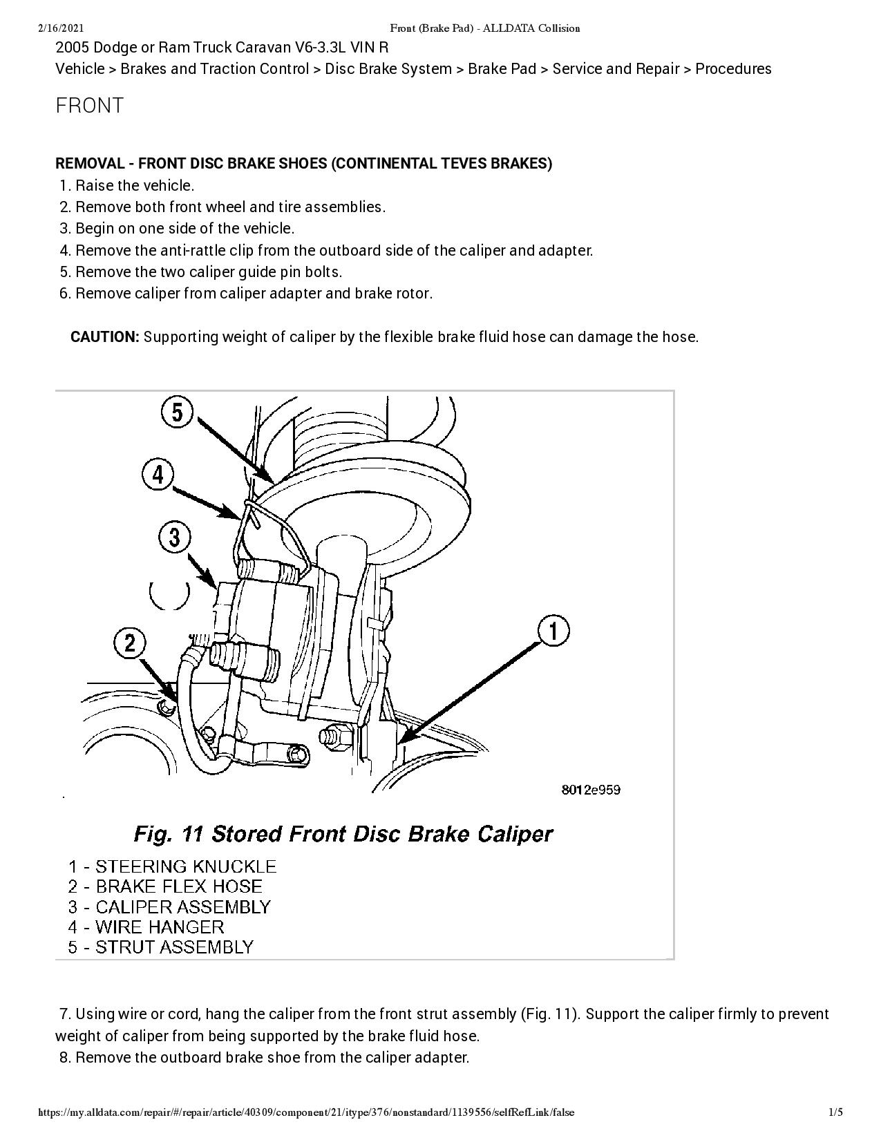

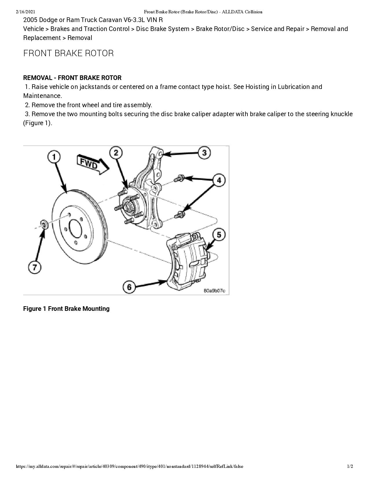

Hey harlan2,

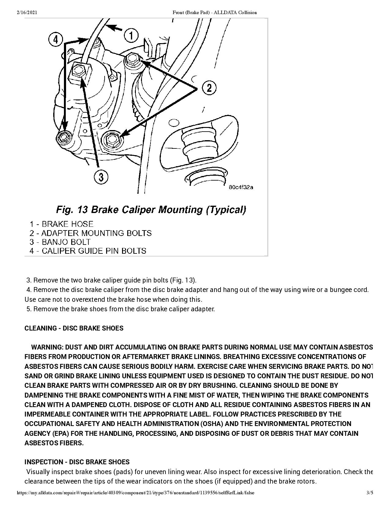

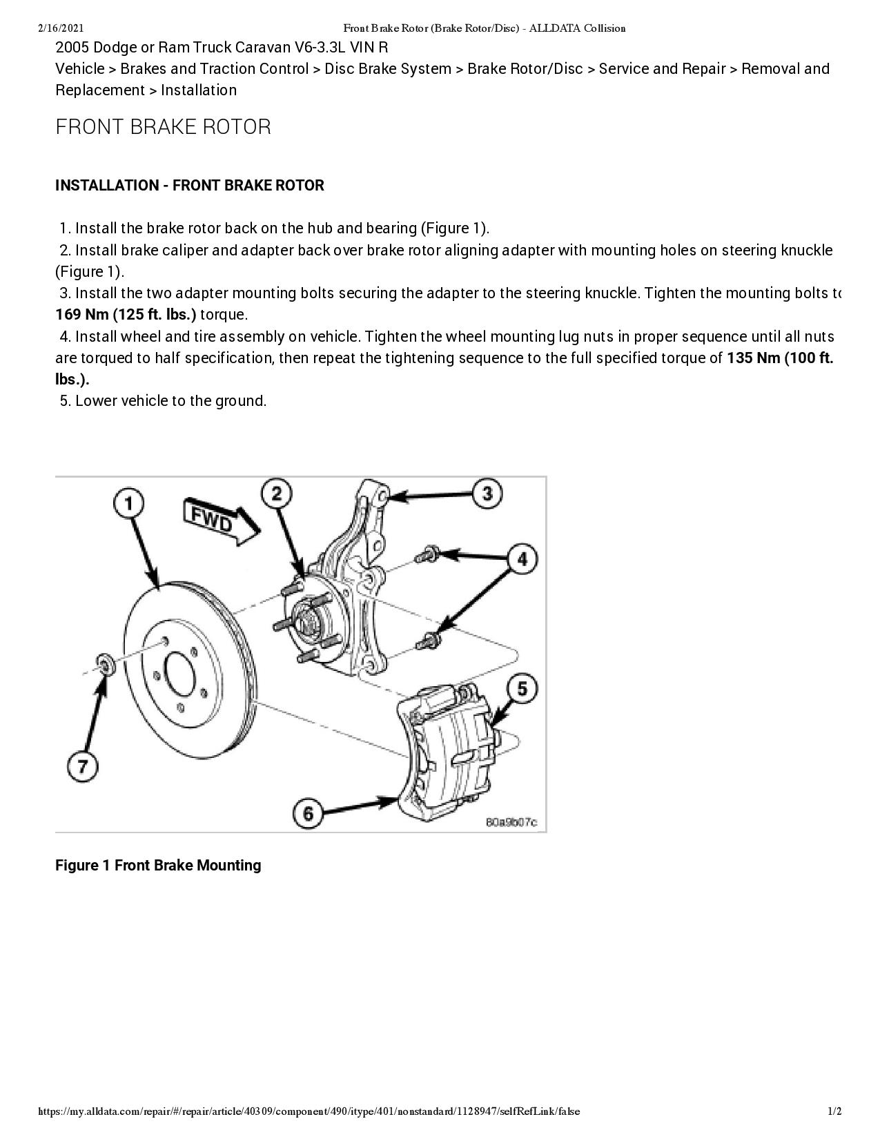

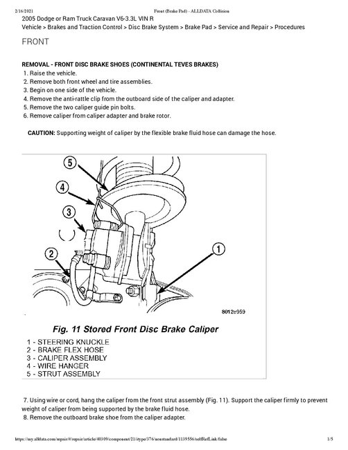

No problem, i have attached below the instructions for replacing front brake pads followed by instructions for replacing the rotors. Also for some really useful information for replacing your front brake pads and rotors be sure to check out the repair guide at the link below. Here is a guide to help you step by step with instructions in the diagrams below to show you how on your car.
https://youtu.be/SD9-MLW6Yts
You will need to start with removing the brake pads, then follow the remove and replace for the rotors.Once the rotors are fitted you can return to the brake pad instructions for installation. Check out the diagrams (Below). Please let us know if you need anything else to get the problem fixed.
