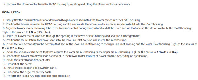

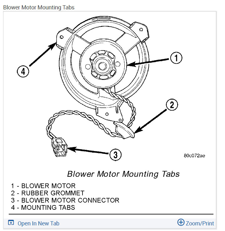

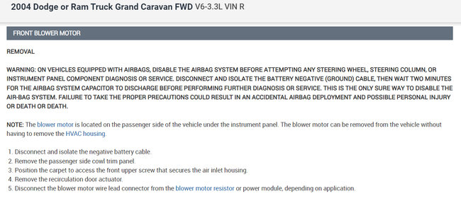

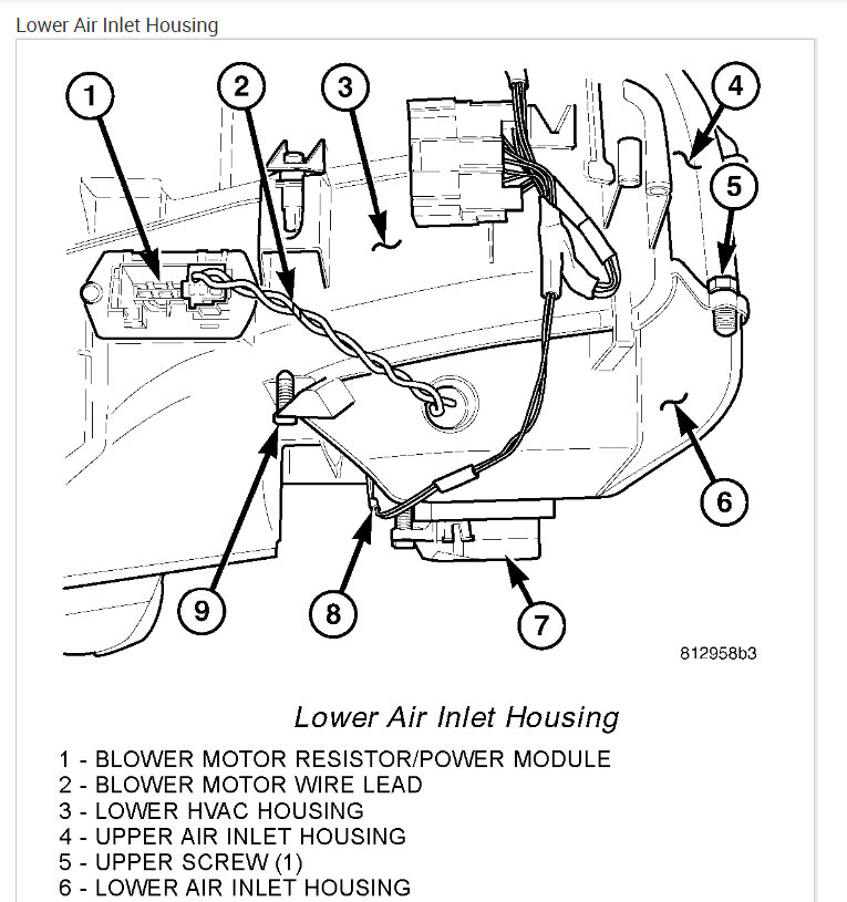

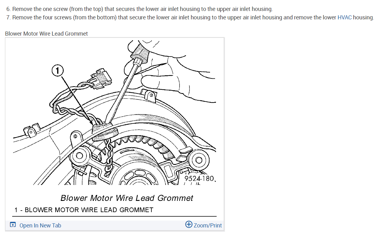

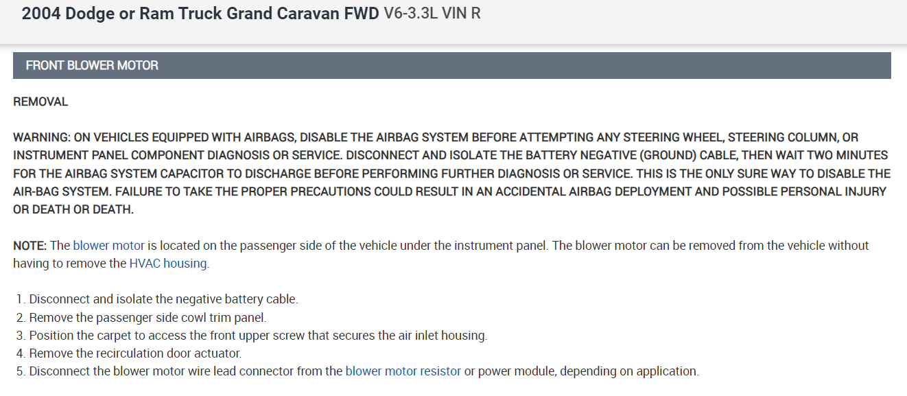

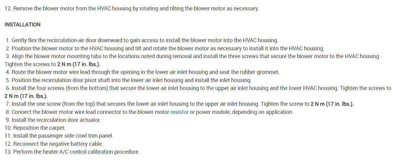

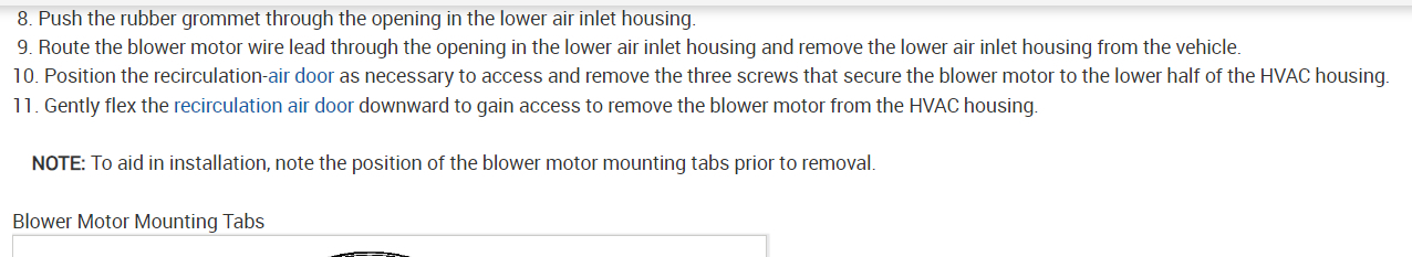

Here is the location of the blower motor and how to change it out. Check out the images (below). Let us know if you need anything else.
