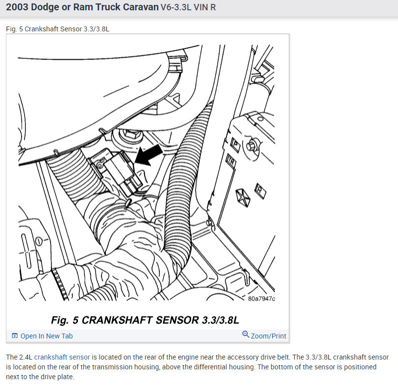

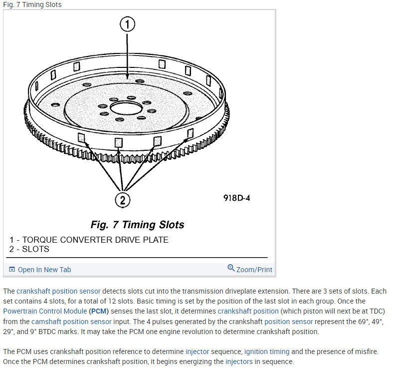

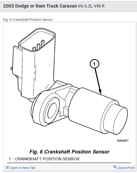

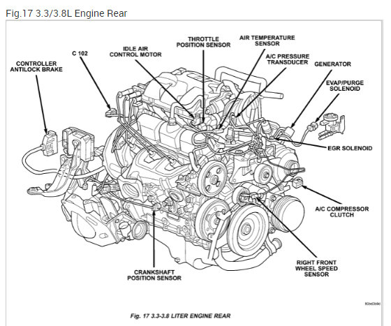

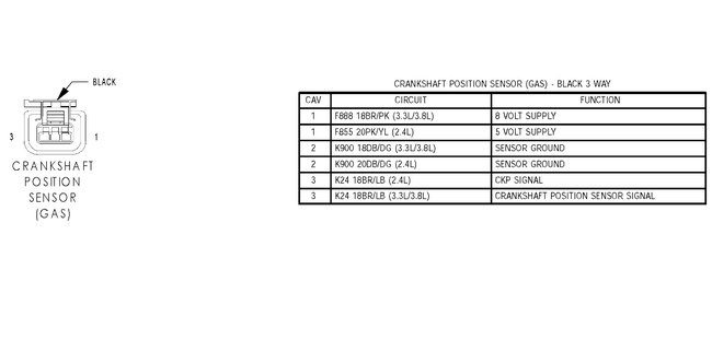

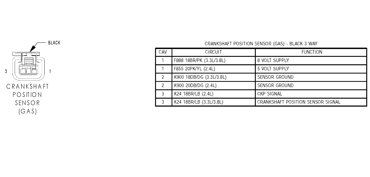

First make sure you are getting spark to the plugs.
Then check fuel pump.

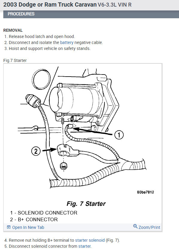

This vehicle has a fuel pump control module which sometimes goes bad and makes the fuel pump inspirational. It is located on the floorboard rear passenger side (see diagram below)

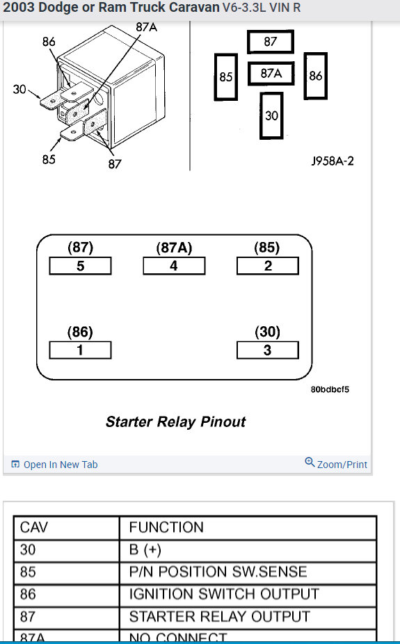

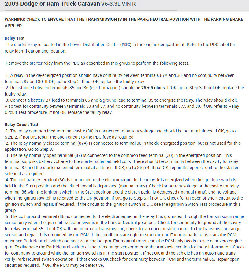

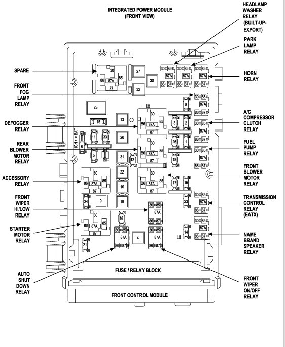

If you can't hear the pump come on check the relay then test the pressure to verify.
Here is a helpful guide on how to test fuel pressure:
https://www.2carpros.com/articles/how-a-fuel-pump-works

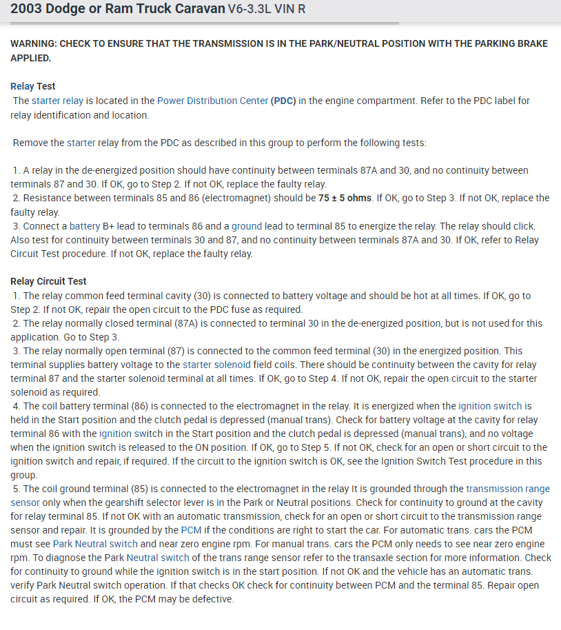

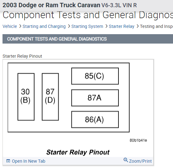

You can also test the relay. The relay is located under the hood in the fuse block.

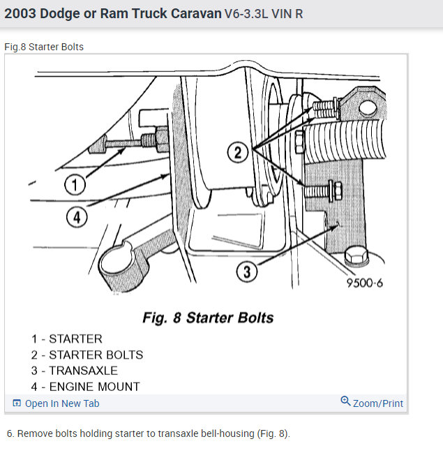

I have attached the diagrams for your reference.
