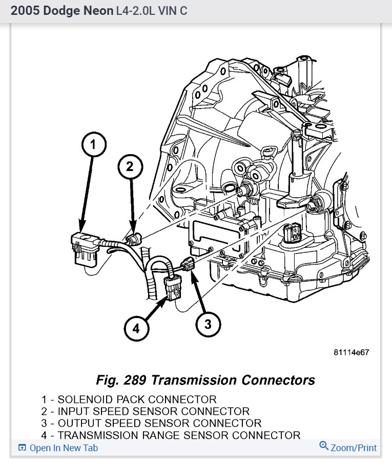

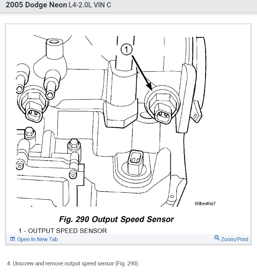

Had a weak battery and when trying to start engine, speedometer went nearly all the way around the gauge. Now speedometer does not work at all and trans does not shift correctly. I had problem with trans once before and had to change transmission brain. I don't think that is the problem now and I am leaning toward a faulty speed sensor but I am not sure if I should change input or output side
Sep 9, 2010 at 10:18 AM
If they both are not working properly, I would say the speed sensor. Here is the location so you can change it out. Same as a Neon. Check out the diagrams (Below). Please let us know what happens.
