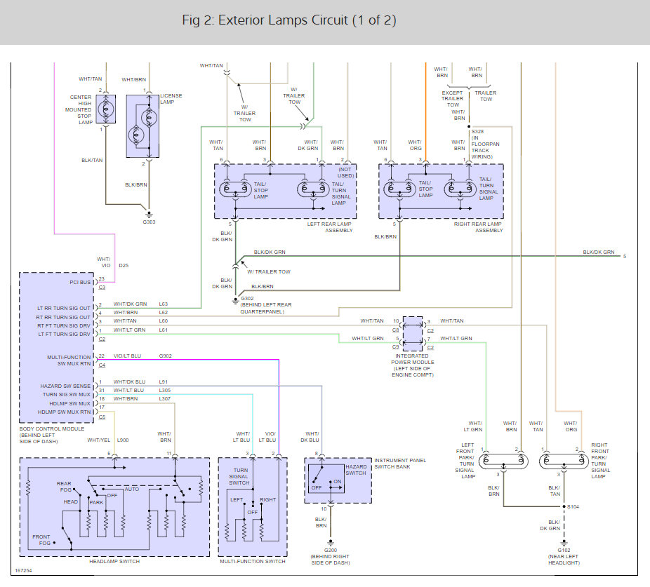

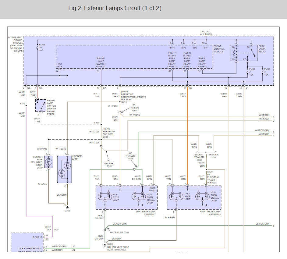

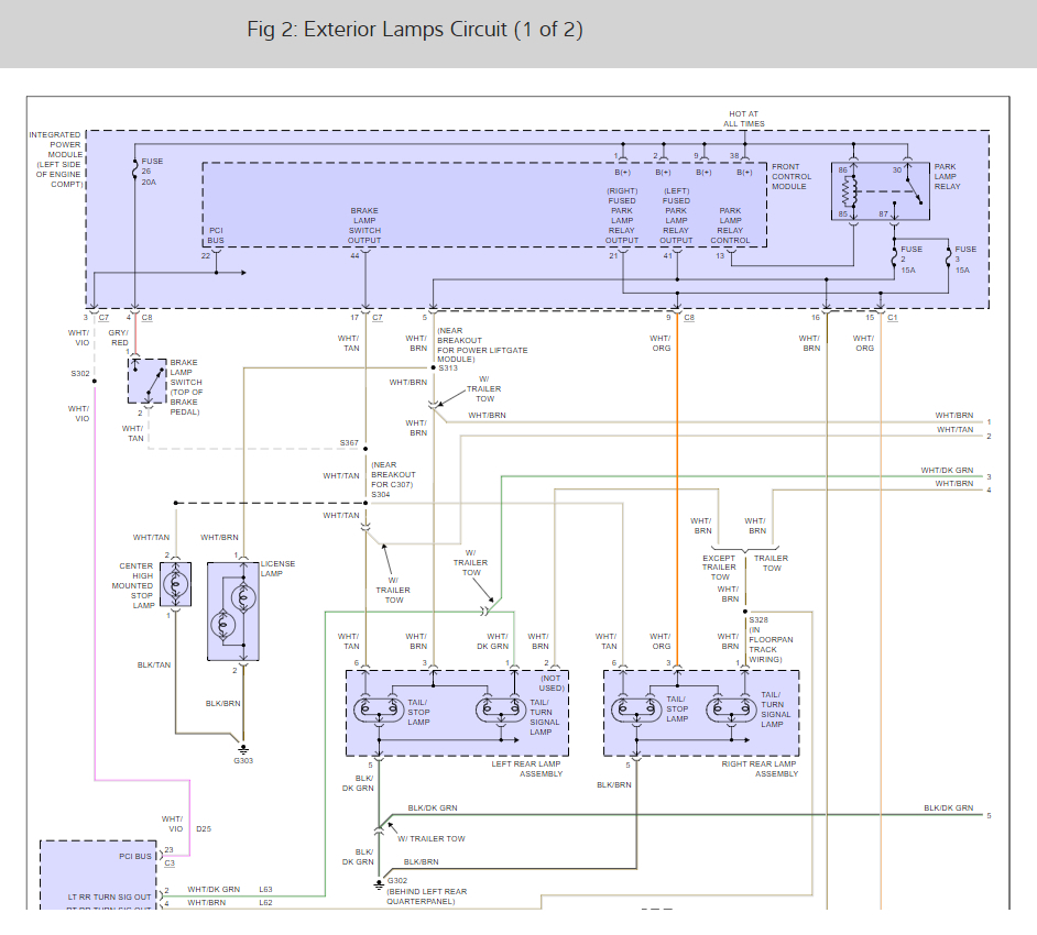

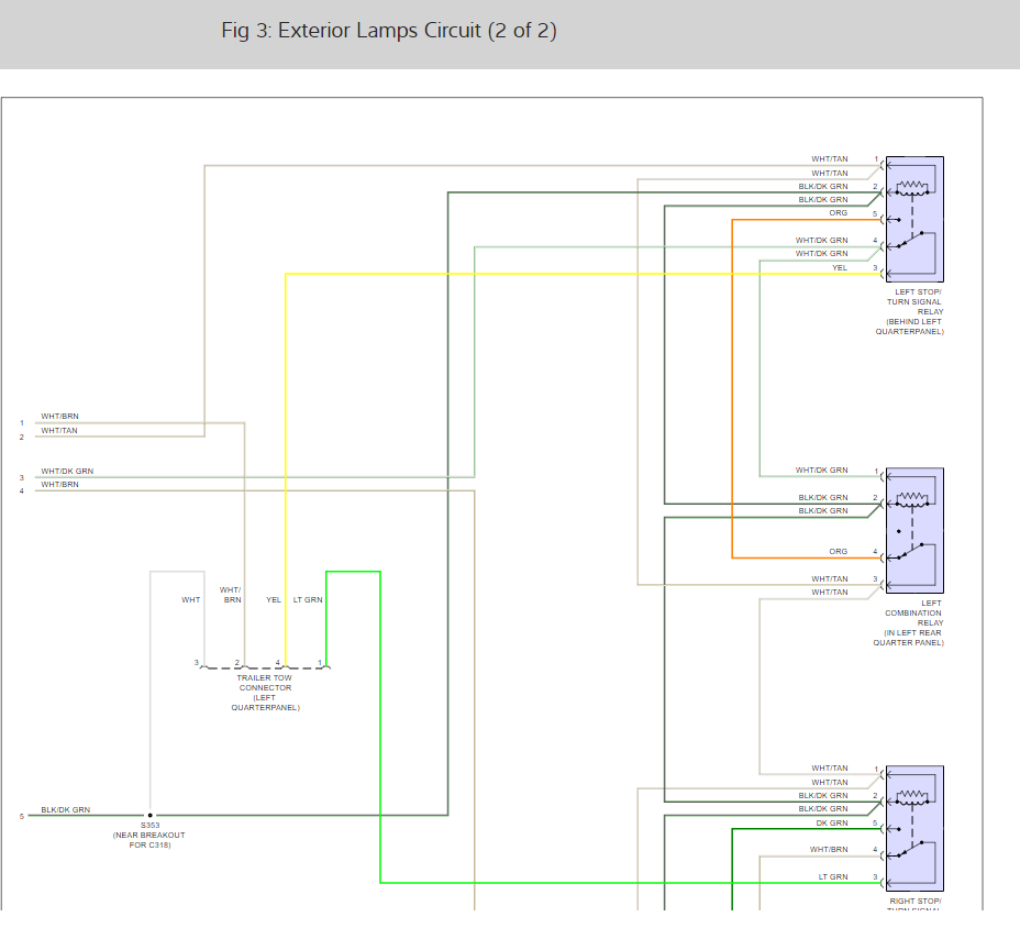

Hello, does the high mount brake light work? At the brake switch, the gray wire with red tracer is the feed circuit to the switch, hot all the time. White wire with tan tracer is the feed to the brake lites. Check both circuits with the brake switch activated. The high mount brake lite shouldn't effect the others. Check the white wire with the tan stripe at the rear for voltage, with the brake switch activated. If you have good voltage, check the ground. Did you check the bulbs and everything at the rear?
Here are some guides and wiring diagrams so you can do some simple testing.
https://www.2carpros.com/articles/brake-lights-not-working
and

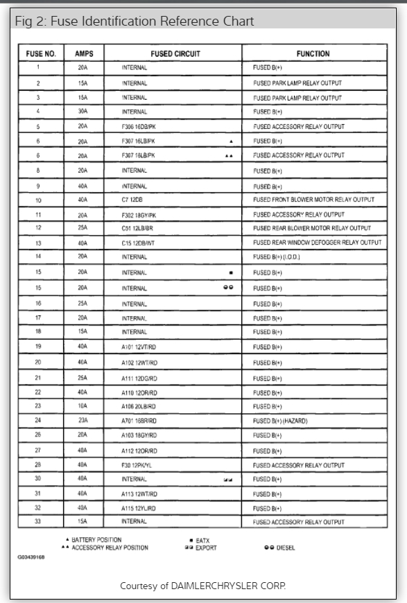

And so you can double check the fuses #26
Here is the the brake light wiring diagrams so you can do some easy testing and see where you lose power at.
Cheers
