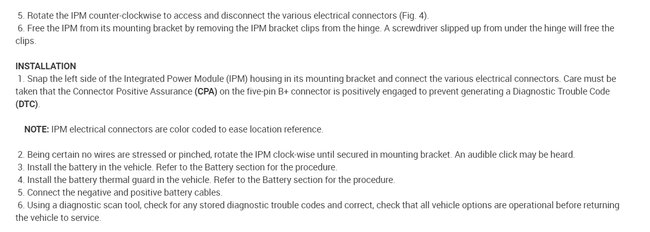

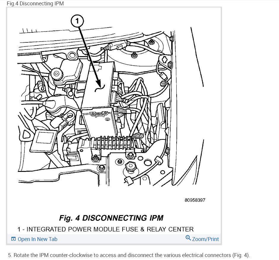

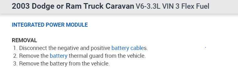

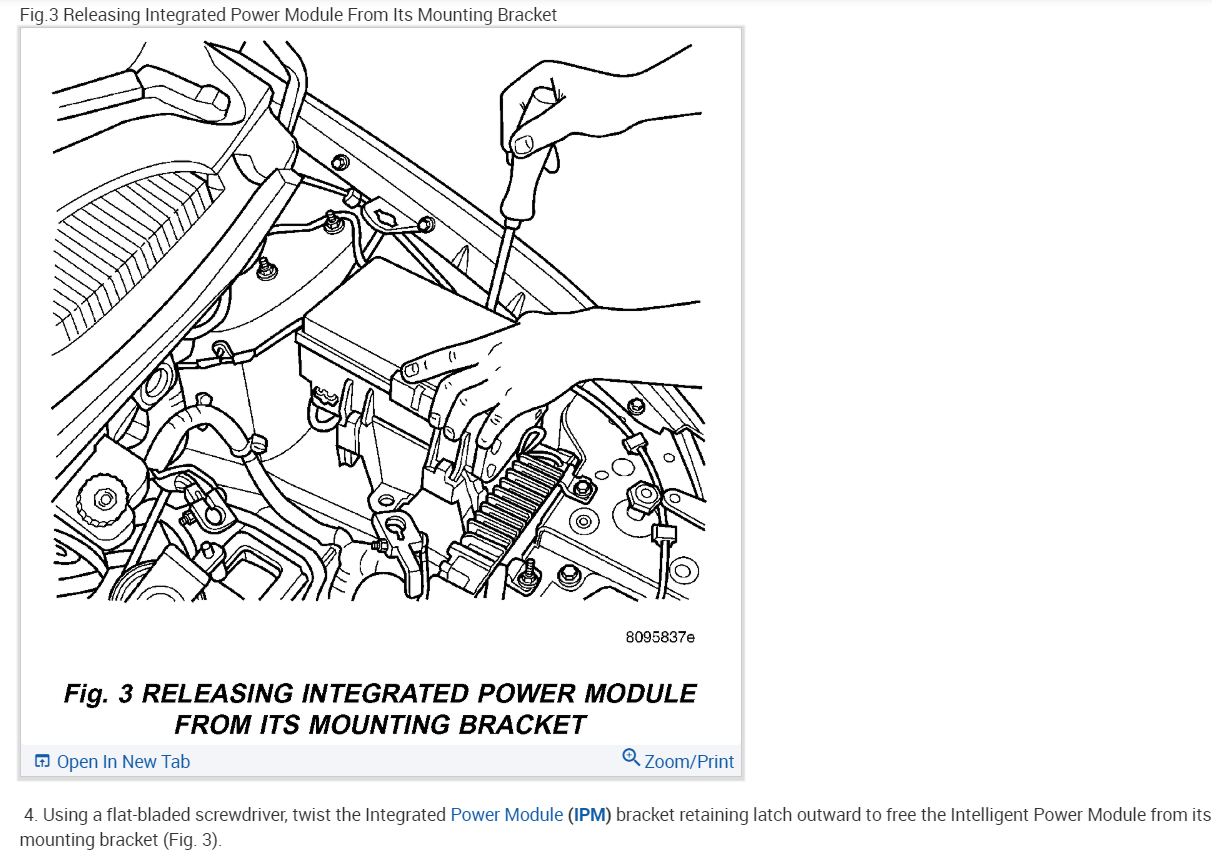

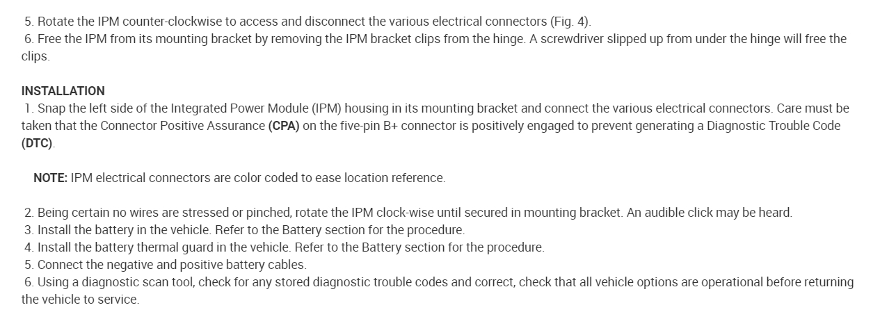

This is typical when the TIPM goes out which is common here is how you can replace it which is easy because it self initializes. Check out the diagrams (Below). Please let us know what happens.
