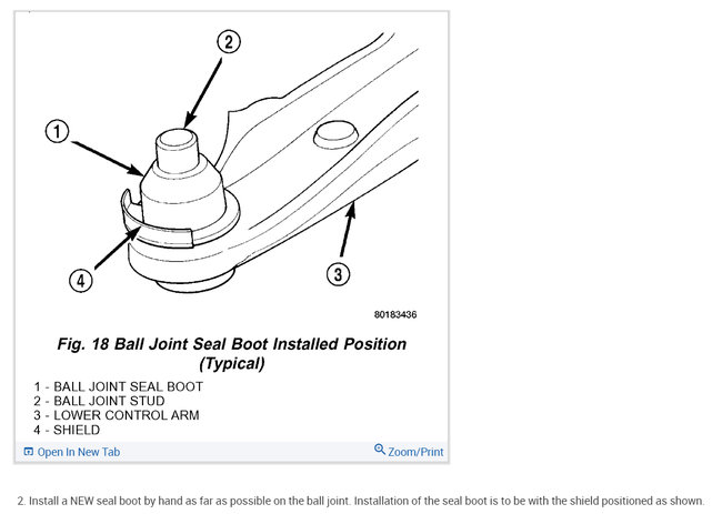

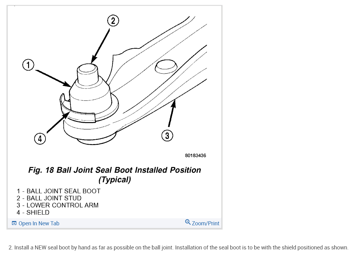

How do you replace the front ball joints?
Aug 28, 2009 at 8:25 PM
MERLIN2021
  • 17,250 POSTS
With the weight of the vehicle resting on the road wheels, grasp the special fitting cap on the bottom of the ball joint and with no mechanical assistance or added force, attempt to rotate the grease fitting. If the ball joint is worn, the grease fitting will rotate easily. If movement is noted, replacement of the control arm is recommended. Check out the diagrams (Below). Please let us know if you need anything else to get the problem fixed.

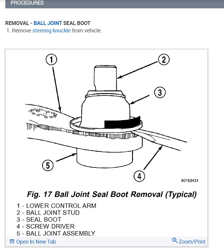

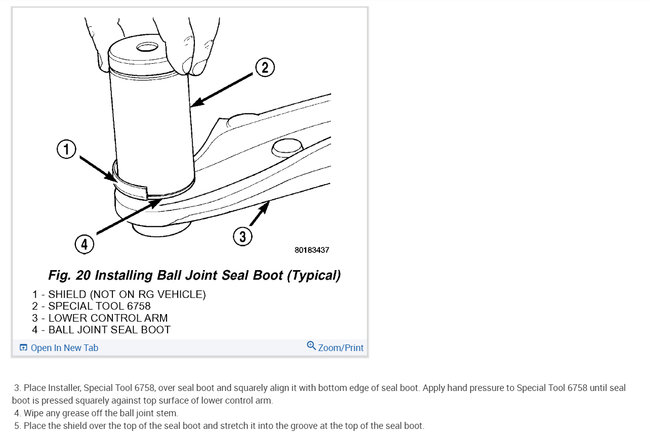

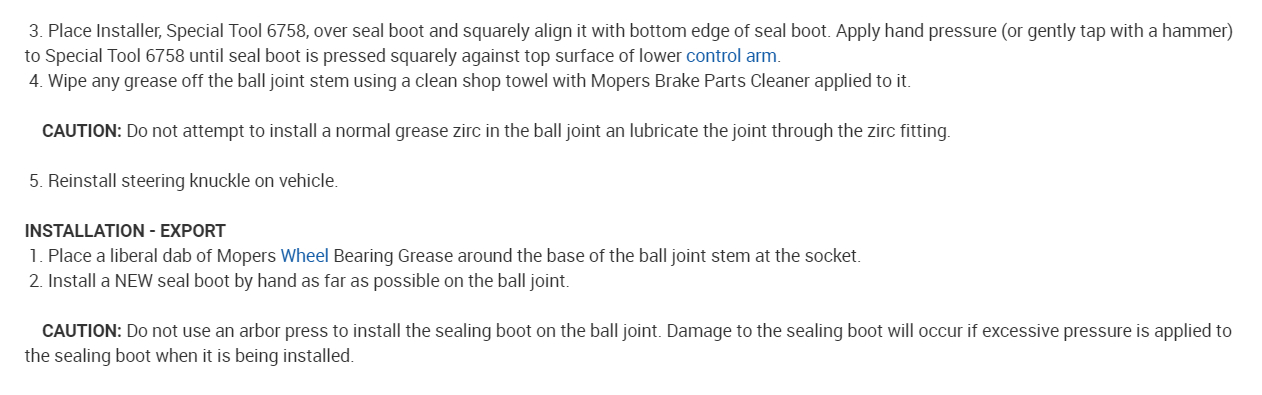

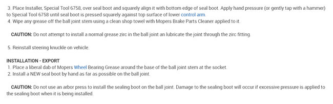

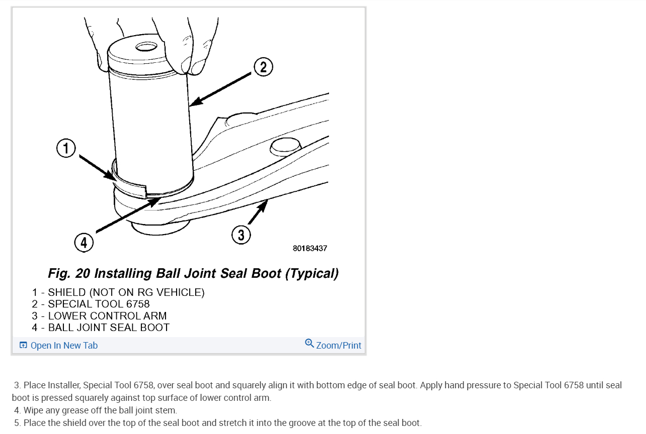

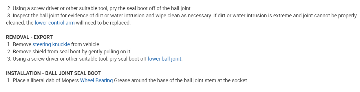

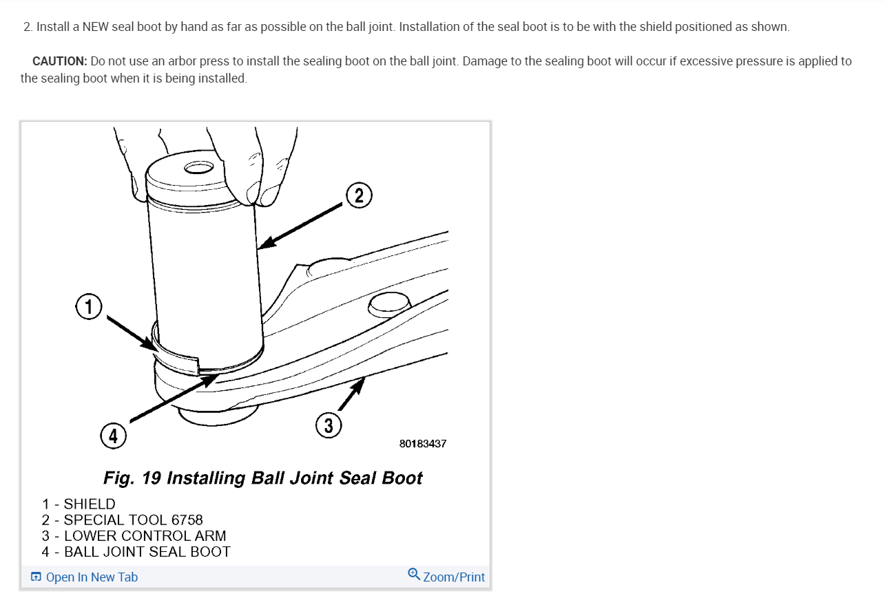

Removal (Ball Joint) 1. Remove steering knuckle. See STEERING KNUCKLE under REMOVAL & INSTALLATION. Pry off dust seal. Position Receiving Cup (C-4699-2) to support lower control arm while receiving ball joint. 2. Install a 1 1/16" deep socket over stud and against joint upper housing. Press down against ball joint upper housing to remove ball joint assembly from control arm. Installation 1. Position new ball joint housing into control arm cavity. Position assembly in press using Installer (C-4699-1 ) to support control arm. Align and press assembly until ball joint housing ledge stops against control arm cavity down flange. 2. Support ball joint housing using receiving cup. Position new seal over stud and housing. Using a 1 1/2" socket, press seal onto joint housing until seal seats against control arm. To complete installation, reverse removal procedure. Tighten bolts to specification. See TORQUE SPECIFICATIONS NOTE: During any service procedures in which knuckle and drive shaft are separated, thoroughly clean seal and wear sleeve with solvent. Lubricate both components.

The lower front suspension ball joints operate with no free-play. The ball joint housing is pressed into the lower control arm with the joint stud retained in the steering knuckle with a (clamp) bolt.
INSPECTION
With the weight of the vehicle resting on the ground, grasp the ball joint grease fitting, and attempt to move it. If the ball joint is worn the grease fitting will move easily. If movement is noted, replacement of the ball joint is recommended.
REMOVAL:
Special Chrysler Tools C-4699-1 and C-4699-2, or their equivalents, are required to remove and install the ball joint form the lower control arm. If the tools are not on hand, remove the control arm and have an automotive machine shop press the ball joint out and in.
Remove the lower control arm. Pry off the seal from the ball joint.
Position a receiving cup, special tool C-4699-2, or its equivalent, to support the lower control arm.
Install a 11/8 in. deep socket over the stud and against the joint upper housing.
Press the joint assembly from the arm.
INSTALLATION:
Position the ball joint housing into the control arm cavity.
Position the assembly in a press with special tool C-4699-1, or its equivalent, supporting the control arm.
Align the ball joint assembly, then press it until the housing ledge stops against the control arm cavity down flange.
To install a new seal, support the ball joint housing with tool C-4699-2 and place a new seal over the stud, against the housing.
With a 11/2 in. socket, press the seal onto the joint housing with the seat against the control arm. Install control arm.
