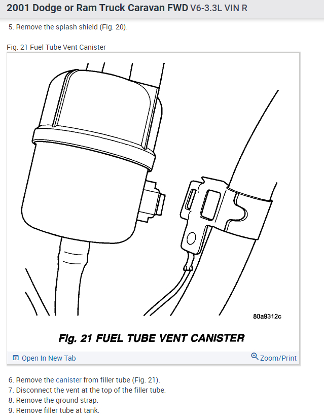

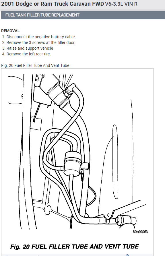

So the best option when you have a crack in the fuel filler tubing is to replace it. That will seal the system. Then you can clear the code and the engine light should not come back on given there are no more leaks.
https://youtu.be/ahK_eucFi-k
