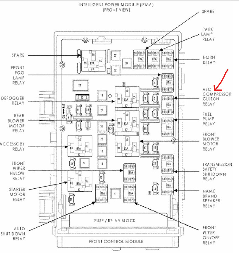

One of the most common item to cause a battery drain is the AC compressor control relay sticking on or a CD or coins stuck in the player. I would remove the control relay to see if that helps. Please check out this guide can well.
https://www.2carpros.com/articles/car-battery-dead-overnight
Here is the location of the relay so you can do the first step. After that remove the radio/CD player. Check out the images (below). Let us know how it goes
