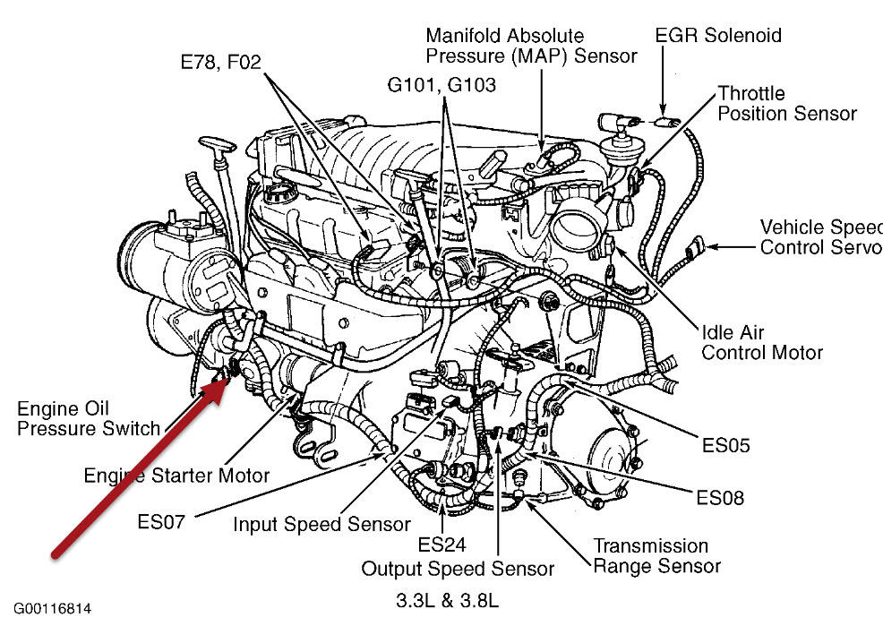

the oil light and chime going off constantly. The oil level is good. before I brought it in to the shop, I thought I would change the oil pressure sensor. Where is this thing located? Do I need to drain the oil before I do it? Do you think this will solve the problem? Should I bring it in and have a professional look at it?
Feb 12, 2009 at 5:17 PM
RASMATAZ
  • 75,992 POSTS
Here is a diagrams below that shows its location near the oil filter. Check out the diagrams (Below). Please let us know if you need anything else to get the problem fixed.

A 3.3L and 3.8L engines its below AC compressor and 3.0 is near the starter

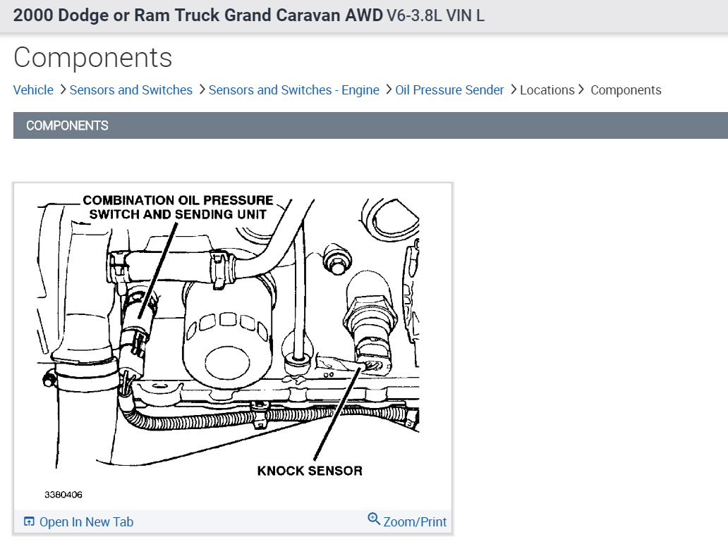

if you are talking about the oil pressure switch see pic. there is no oil sensor

My oil pressure light comes on and the warning bells start dinging when I first turn the car on and the engine is cool. I have had the oil changed and all parts seem to be in working order with no leakage. When I reach a certain RPM, the light and bells go off, but when I come back to idle, off the go again until the engine heats up! Could this be the oil pressure switch and is this something I can change out myself?
Nov 23, 2018 at 6:46 PM (Merged)
RACEFAN966
  • 5,029 POSTS
Yes this could be the oil pressure switch infact that is the first thing I would change. You should be able to do it your self. It should be next to the oil filter. This is what it should look like for the 3.3ltr and 3.8 ltr engine.
https://www.2carpros.com/forum/automotive_pictures/249564_275888_1.jpg
Hope this helps you.
