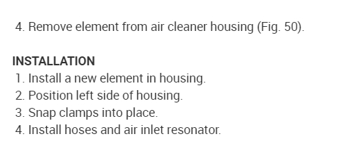

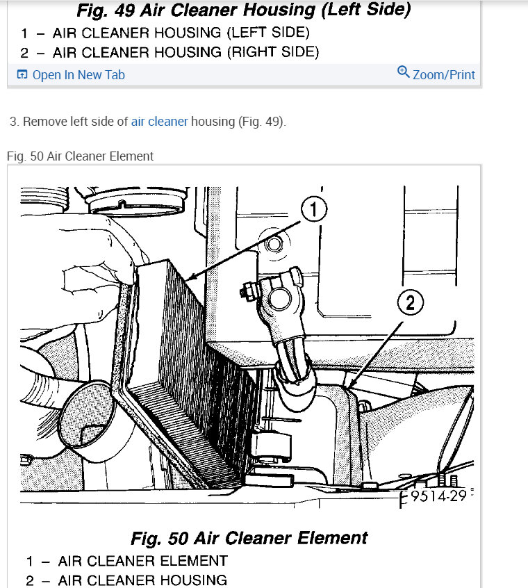

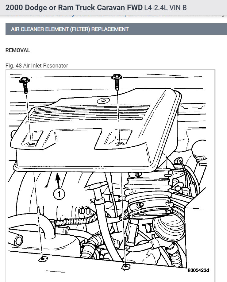

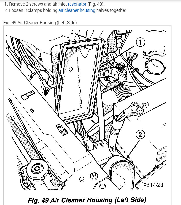

SATURNTECH9
  • 30,869 POSTS
https://www.2carpros.com/forum/automotive_pictures/416332_1996_dodge_carvan_air_cleaner_replacement_part1_1.jpg
https://www.2carpros.com/forum/automotive_pictures/416332_1996_dodge_carvan_air_cleaner_replacement_part2_1.jpg
https://www.2carpros.com/forum/automotive_pictures/416332_1996_dodge_carvan_air_cleaner_replacement_part3_1.jpg
REMOVAL 1. Remove 2 screws and air inlet resonator (Fig. 125). 2. Loosen 3 clamps holding air cleaner housing halves together. Fig 126 Air Cleaner Housing (Left Side) 3. Remove left side of air cleaner housing (Fig. 126). Fig 127 Air Cleaner Element 4. Remove element from air cleaner housing (Fig. 127). INSTALLATION 1. Install a new element in housing. 2. Position left side of housing. 3. Snap clamps into place. 4. Install hoses and air inlet resonator. There is your instruction's i have never seen a orange air filter element maybe you mean a orange border air filter.I would just get a fram one there really good.
