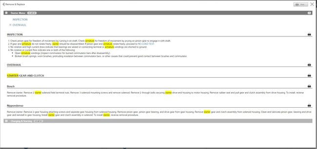

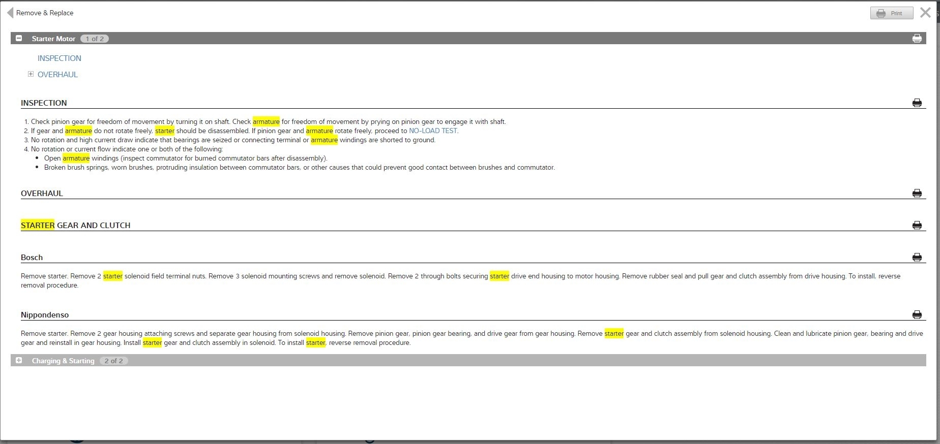

Welcome to the forum, take the negative battery cable loose. The pictures below, came from autozone.
https://www.2carpros.com/forum/automotive_pictures/170934_starter_removal_1_1.jpg
https://www.2carpros.com/forum/automotive_pictures/170934_starter_removal_2_1.jpg
https://www.2carpros.com/forum/automotive_pictures/170934_starter_removal_3_1.jpg
