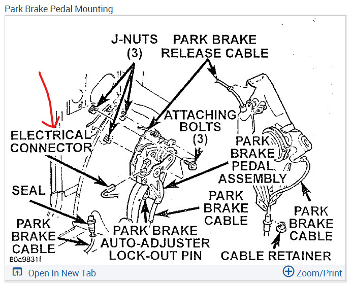

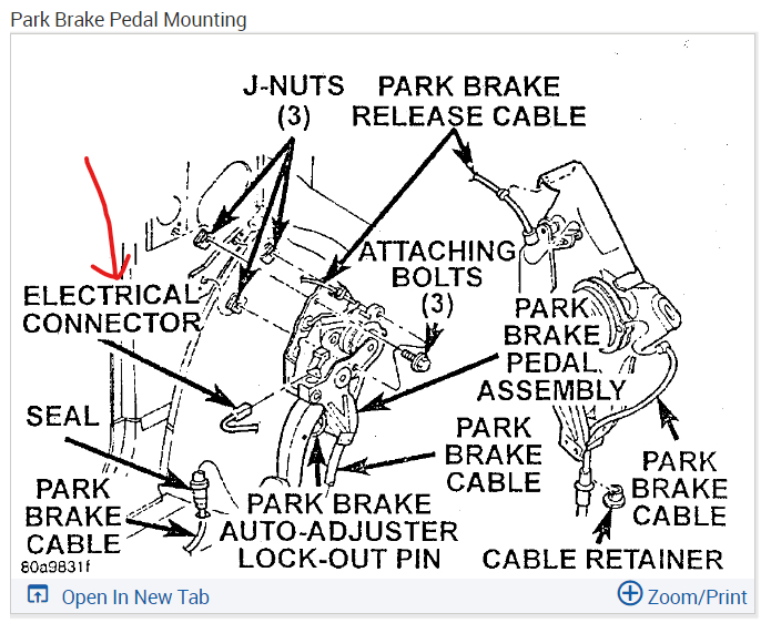

Here is how to bleed the ABS system, you can do it yourself, also I would check the parking brake inductor switch it might be broken or not adjusted correctly. This guide can help us as well.
https://www.2carpros.com/articles/brake-system-warning-light-on
Check out the images (below). Let us know how it goes
