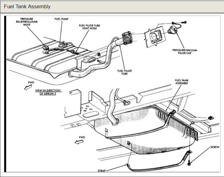

My gas gauge swings wildly after it reaches 3/4 tank or less, and constantly sets off the alert chime. Is there a way to turn off the chime until I can get the fuel sensor replaced?
Aug 18, 2008 at 7:46 AM

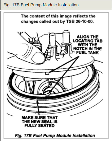

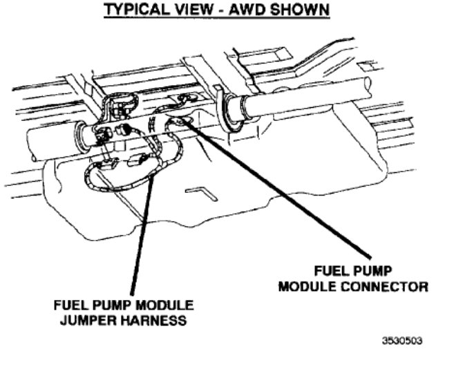

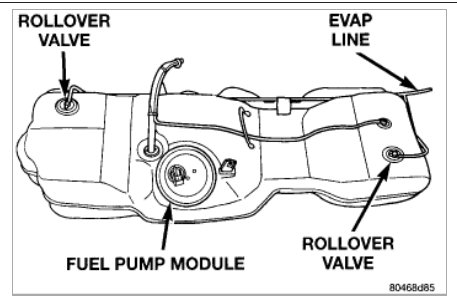

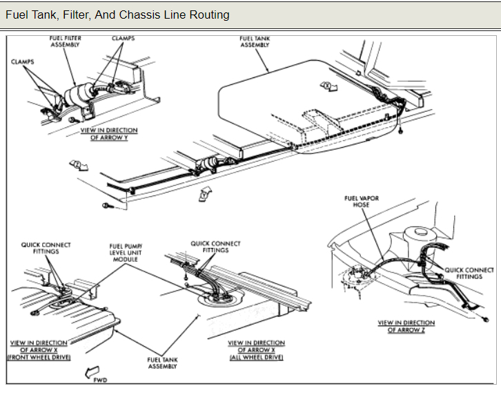

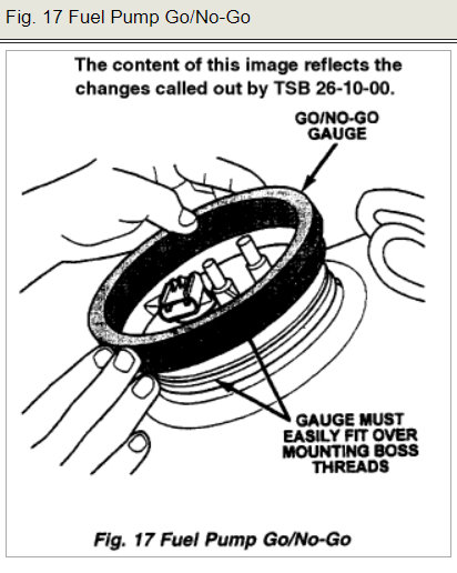

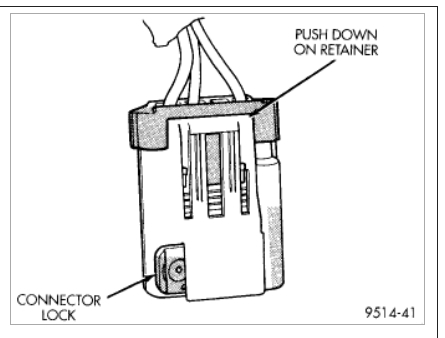

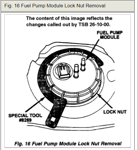

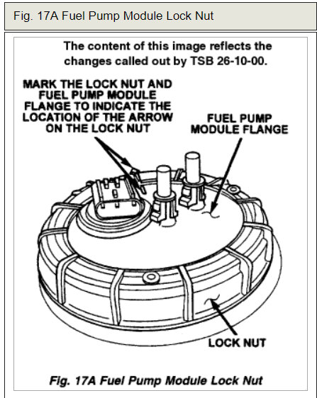

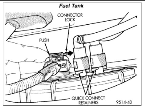

There is no way to remove the chime warning you will need to replace the sender and fuel pump module which is causing the problem.
Here is a guide to give you an idea of what you are in for when doing the job.
Here is how it will be on your car (below)
