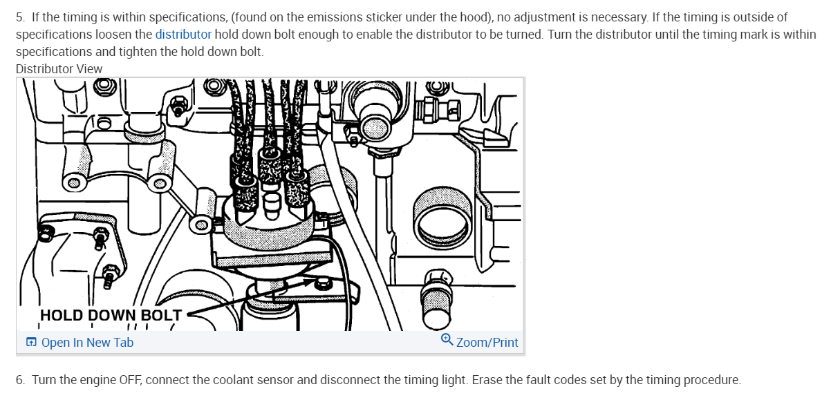

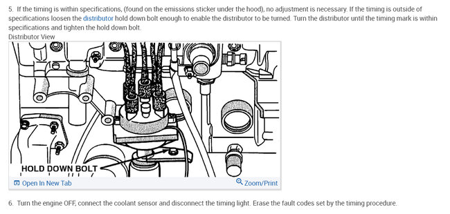

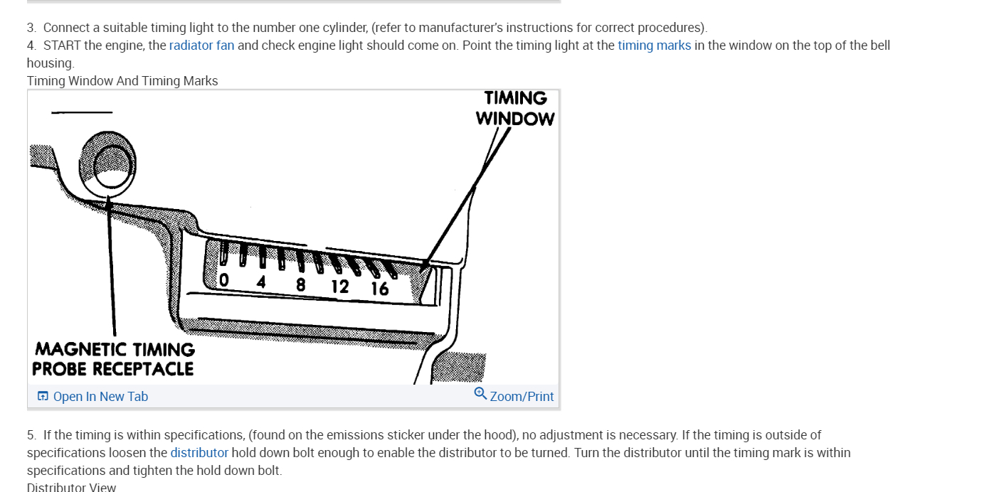

Spark Control Computer Basic Timing
5226575 12 deg BTDC
5226525 12 deg BTDC
MD116211 12 deg BTDC
Check out the images (Below). Please let us know if you need anything else to get the problem fixed.
