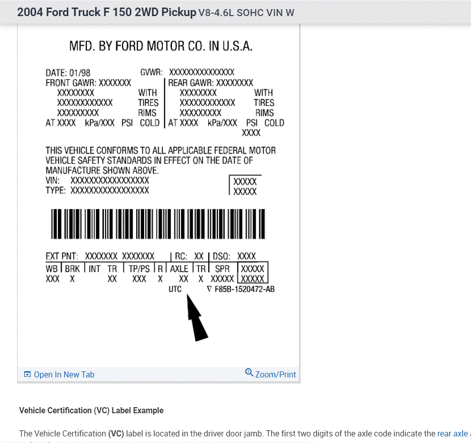

The 8.8" can be either locking or non-locking. The locking does require an additive. If that is what you have, add 4oz of friction modifier XL-3. I would actually suggest using it regardless.
If you want, I attached a pic below showing how to identify the differential.
