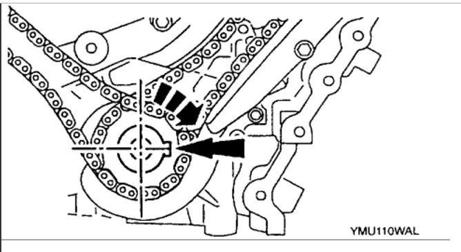

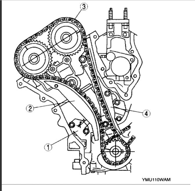

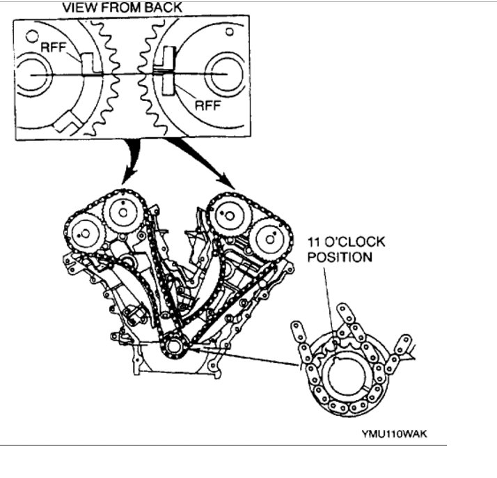

It could be becasue the timing is off on the camshaft, please do a compression test to see what it is.
and
Here is a diagram so you can double check it. (below)
