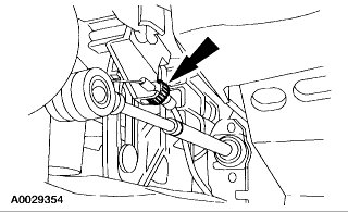

Try to adjust the indicator. Skipping some steps and pictures since you already removed the column you should understand the procedure.
Remove the lower cover and remove the column covers.
Here is the rest of the procedure:
Remove the upper steering column shroud.
Rotate the gearshift lever clockwise until it bottoms out (first gear), then rotate it counterclockwise three detents (D position).
Hang a 1.4 kg (3 lb) weight on the gearshift lever.
Rotate the thumbwheel to center the selector lever indicator in the middle of the D position.
Remove the 1.4 kg (3 lb) weight .
Rotate the gearshift lever into each detent to verify that the selector lever indicator matches the selected range. Readjust, if necessary
Hopefully that helps you out. Let us know how it goes.
