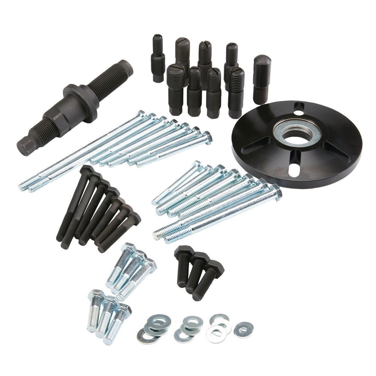

You need to lower it to get room enough to get the balancer off the crank snout. There isn't enough room for the puller and crank snout with the engine in stock position. You need the remover and installer kit to get it off and back on. You can generally get it as a loaner tool.

Ok just a fyi. I used a cheater bar to pop the bolt on the Pulley. The AutoZone has a loaner tool #57139 it's a low profile puller for Chrysler and some gm. Got it pulled through the wheel well. All told took me 5 mins to take off didn't have to lower or remove anything. I'll probably have to remove radiator hose to get belt on otherwise just the wheel well. Thanks for the info.

Great idea thanks. Ya I noticed there is a few low profile pullers for gm. Some are pretty cool instead off having to use hooks to grab the back of the pulley the have L shaped notches so it's more like a twist top around the inner arms of the pulley. Reasonabley priced as well.

Straight extension won't do much as long as you keep it straight and it's a good extension. I've tapped them on with soft mallets before. Most of the better installer tools include adapters and a puller rod but they get in the way. Torqueing them is always fun, I use a three quarter drive extra long torque wrench normally.
