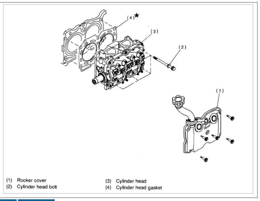

It is a great idea to change the spark plugs when doing this job but be sure to use OEM factory replacements do not fall for aftermarket plugs it will make it run worse.
Here are two guides that will help you see what you are in for when doing the job:
https://www.2carpros.com/articles/how-to-change-spark-plugs
and
https://www.2carpros.com/articles/replace-valve-cover-gasket
Check out the diagrams (below).
