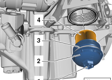

Dealerships and tire shops absolutely love to overcharge for “European vehicle service.” The oil you need to use is:
5W-40 Full Synthetic - 6.3 quarts
Which you can get at Costco or Amazon for a good price.
Good affordable options:
Mobil 1 FS 0W-40 (Walmart favorite)
Castrol Edge 5W-40 European Formula
Valvoline European Vehicle 5W-40
Liqui Moly Leichtlauf 5W-40 (German brand, still affordable)
Price range: $25-$35 for 5-quart jug at Walmart/AutoZone
Oil filter are about $14.00 so, if you do the job yourself you can save. Here is how to raise the car up so you can change the oil.
https://www.youtube.com/watch?v=xLFn_bMkZc0
I included the drain plug and oil filter location in the images below and this video will show you the steps on a similar VW which the steps are the same.
https://www.youtube.com/watch?v=vqEL9XE_2mc
