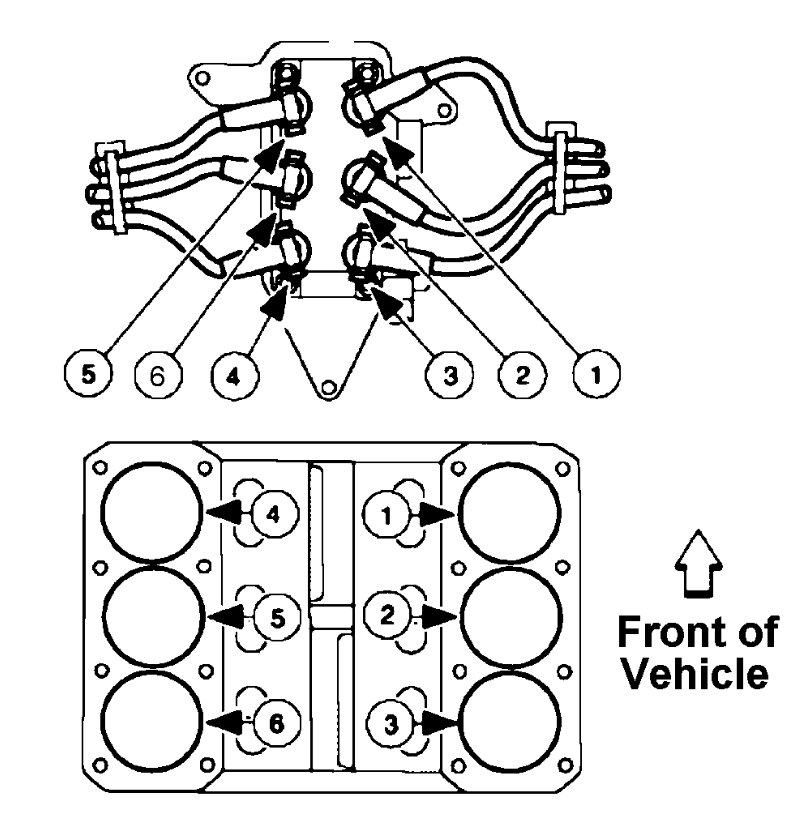

I put new spark plugs in spark of wires and knowledge running rough. I've don't know what I did wrong. But can't find any illustrations on the firing order for this vehicle. Trying to trace each spark plug wire and make sure it's going to the right spot on the distributor cap.
