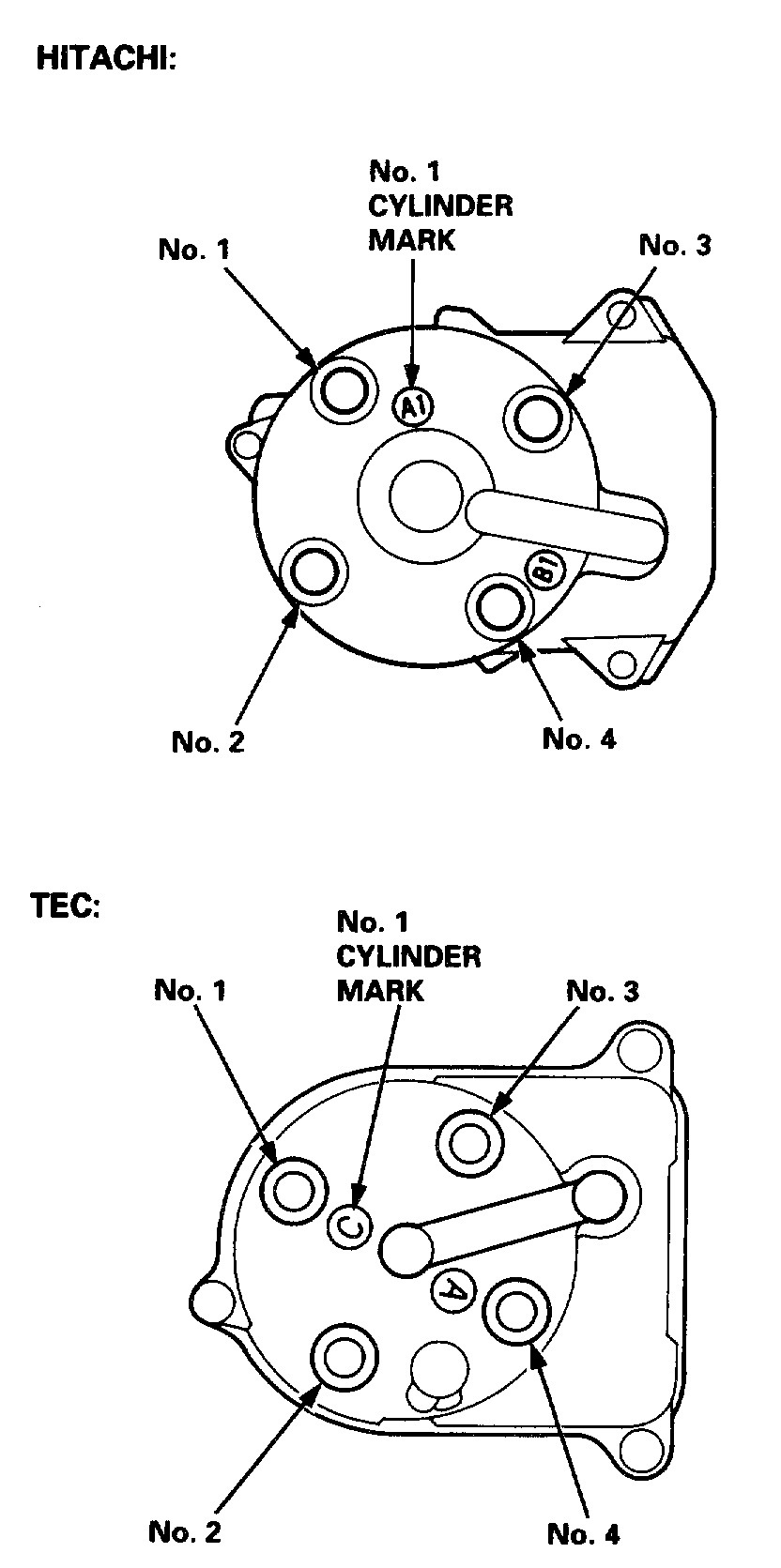

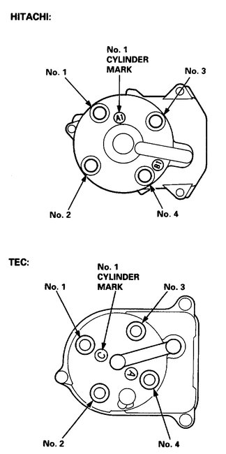

2. Disconnect the ignition wires from the distributor ignition (DI) cap.

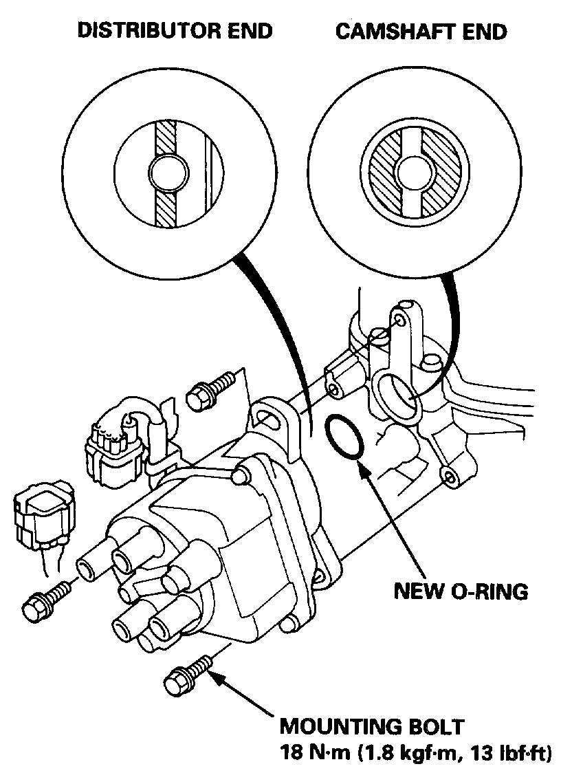

3. Remove the mounting bolts from the distributor, then remove the distributor from the cylinder head.

1. Coat a new O-ring with engine oil, then install it.
2. Slip the distributor into position.
NOTE: The lug on the end of the distributor and its mating grooves in the camshaft end are both offset to eliminate the possibility of installing the distributor 180° out of time.
3. Install the mounting bolts, and tighten them lightly.
4. Connect the ignition wires to the distributor ignition (DI) cap as shown.
