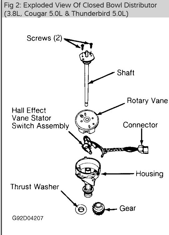

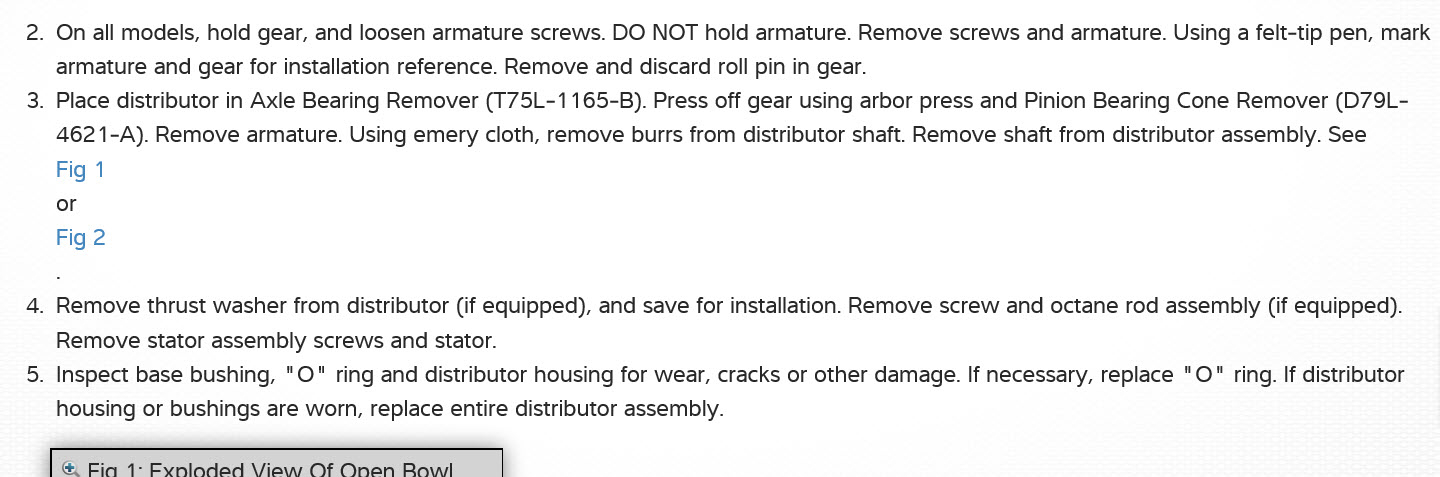

Need to know how to take off the metal plate which is just above the pickups on the distributor.
Jul 31, 2016 at 2:58 PM
HMAC300
CERTIFIED EXPERT
48,601 POSTS
the distributor has to be removed from engine then gear removed to pull up shaft to remove it. see pictures.
