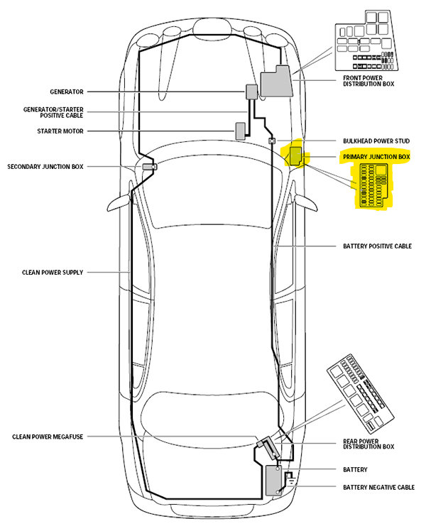

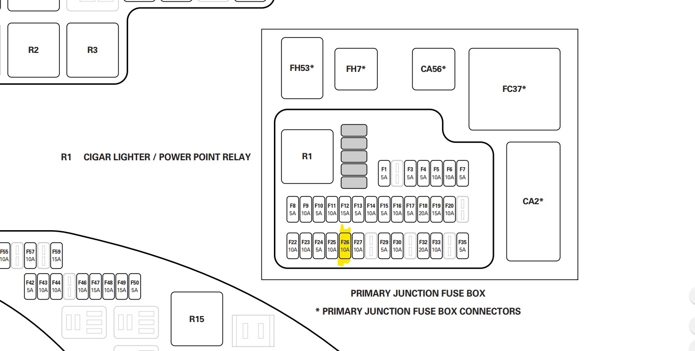

Would you mind uploading a photo? Is it frosting around the edges?
Is your radio not powering on? If so have you checked fuse 26 in the primary fuse box? (Highlighted in yellow)
