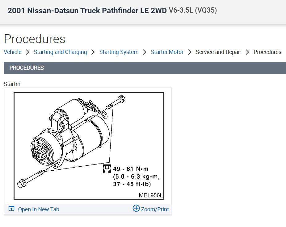

Let's check for power at the starter solenoid trigger wire which will confirm the starter failure, this guide can help you:
https://www.2carpros.com/articles/starter-not-working-repair
Here is the location of the starter motor (right side of the black down low) so you can run the test and replace the starter motor is needed. Check out the images (below). Please let us know what happens.
