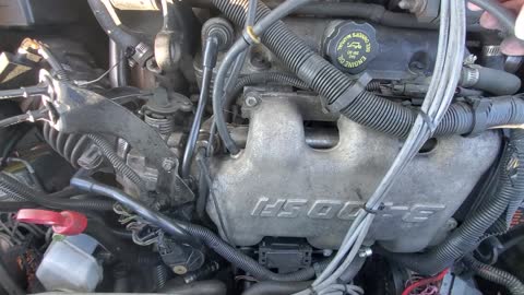

I have this hose coming off the intake manifold that is sucking air in and is not connected to anything. It was originally just draped over the intake manifold, and i found it was disconnected when I was replacing another hose.
There is a check engine light on for P0410 Secondary air injection system, and I am in California.

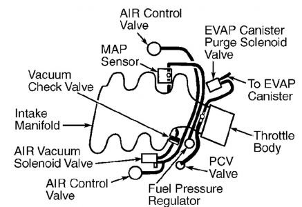

I am assuming by the diagram below that it is supposed to go to the AIR Vacuum Solenoid Valve? or something related. However, I have no idea where this is or how to get it reconnected to see if that solves the code.
Diagram and Video are attached.

Here is a better video:

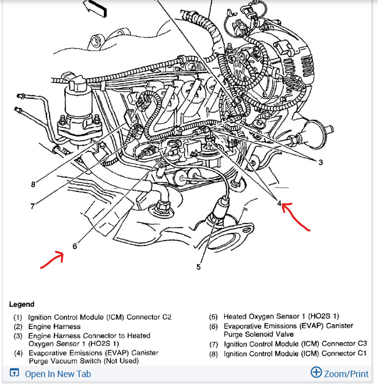

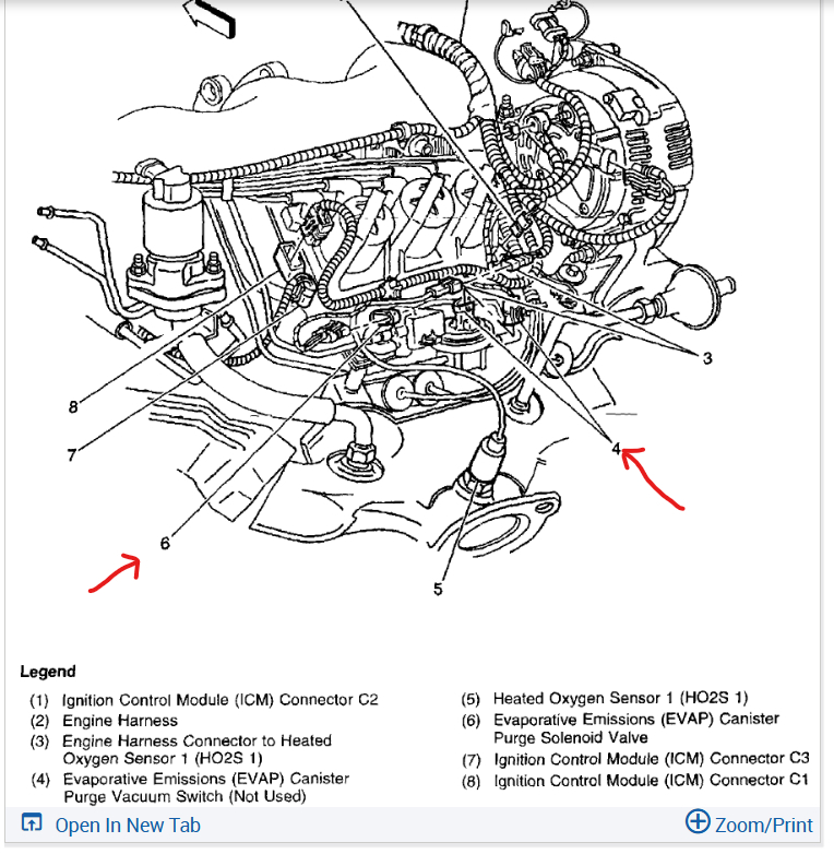

It says it goes to the vacuum solenoid valve. Can you looks around to see if you can find it, it should be within the distance of the hose. I think it goes to the EVAP canister, here is the location so you can check it out. Check out the images (below). Please let us know what happens.
