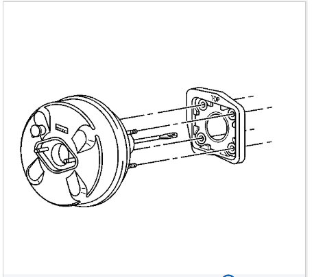

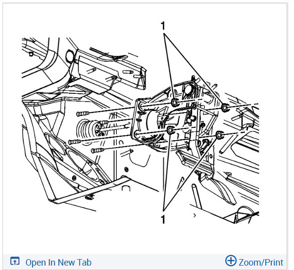

I cannot remove the brake booster I have removed everything I can but I seem to be missing something . Can you help me with directions to remove the brake booster ?
Oct 14, 2025 at 1:54 PM
Have you disconnected the main push rod from the brake pedal inside the car? This is where most people get stuck. Please check the images below and let us know if you have any more troubles, upload images or a short video to help us see what is going on. Check out the images (below).
