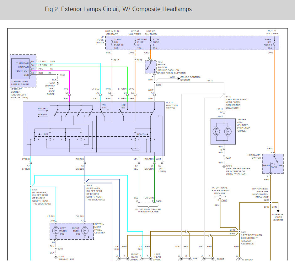

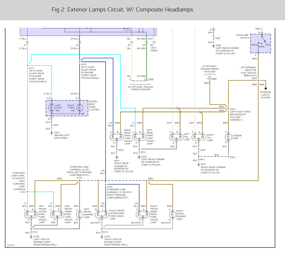

Usually a rapidly blinking blinker means a bad bulb. Changed all the bulbs (2057) on Both sides no change in the problem (right side). Then changed out the entire harness, no change. One commonalty with both harnesses is that the directional bulb burns dim and brake bulb burns bright and when rapidly blinking, tail light directional is very dim. When headlights are on and the brake is depressed, the secondary filament does not go on but when headlights are off, all lights come on when brake is depressed. Cleaned the right side ground up by the tail light. Changed the front directional bulbs as well 2057A. Yes, there is a short somewhere, but where do you start? Especially seeing it is an express van 1500 that has an Emabassy conversion package.
