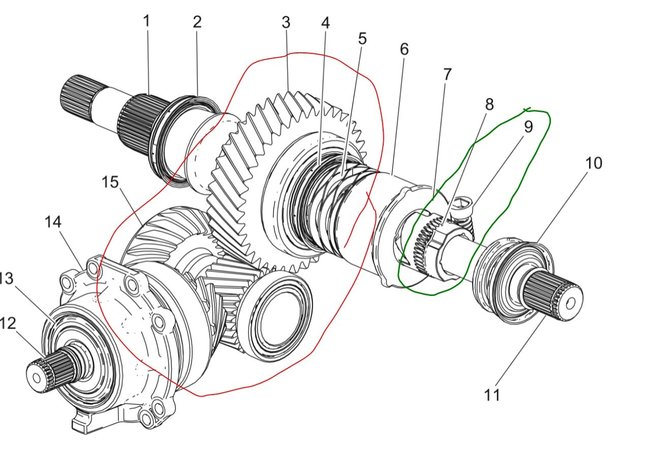

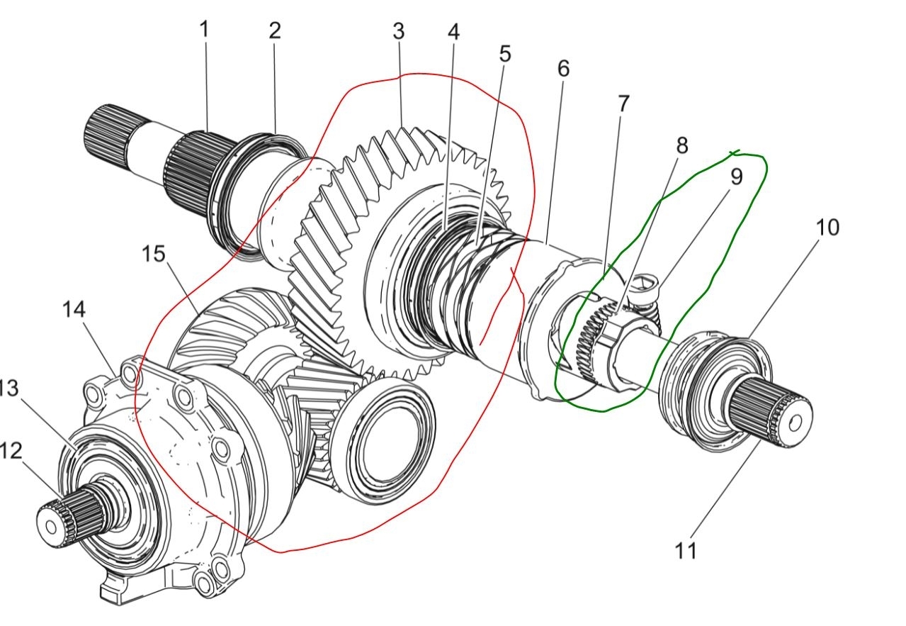

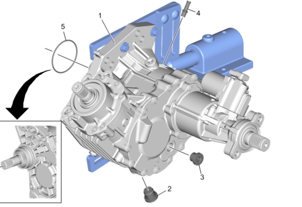

Your Blazer uses a GKN 761 PTU that has different driving modes. In Touring mode, you have front wheel drive only. All the other modes engage the AWD section in one way or another. The attached images are the exterior and the internal gearing, The gears are not the issue themselves, inside they have the clutches (item4) that spin freely while towing.
