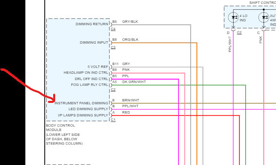

Hey guys, I've added the p9we4 fold warriors and dic mod to my truck with the OEM switches and wiring harness out of the 2002 escalade. I wanted to know what wire or wires can I tap into to provide dimmable lighting to the switches that illuminate them as if they were OEM ?
May 22, 2023 at 1:38 AM

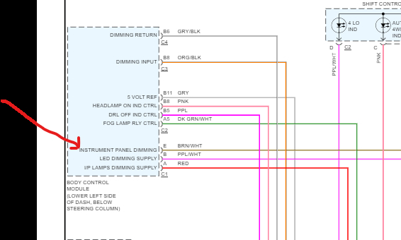

You can tap into the BCM brown/white wire which goes to the instrument cluster bulbs. Check out the images (below). Please let us know if you need anything else to get the problem fixed.
