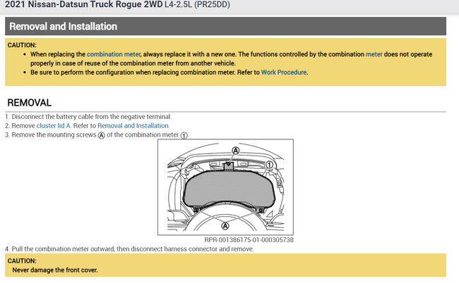

The digital info display between the RPM and speedometer works randomly. Sometimes when you start the car it works but other times stays black. Dealership saying it needs to be replaced for $1,900.00. It’s odd to me that it’s a digital display because it works half the time. I thought I would try a new fuse just for giggles, but the fuse doesn’t appear to be labeled.
Thoughts?
Sep 8, 2022 at 5:57 PM

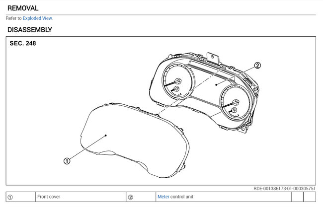

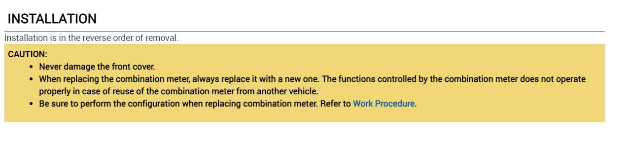

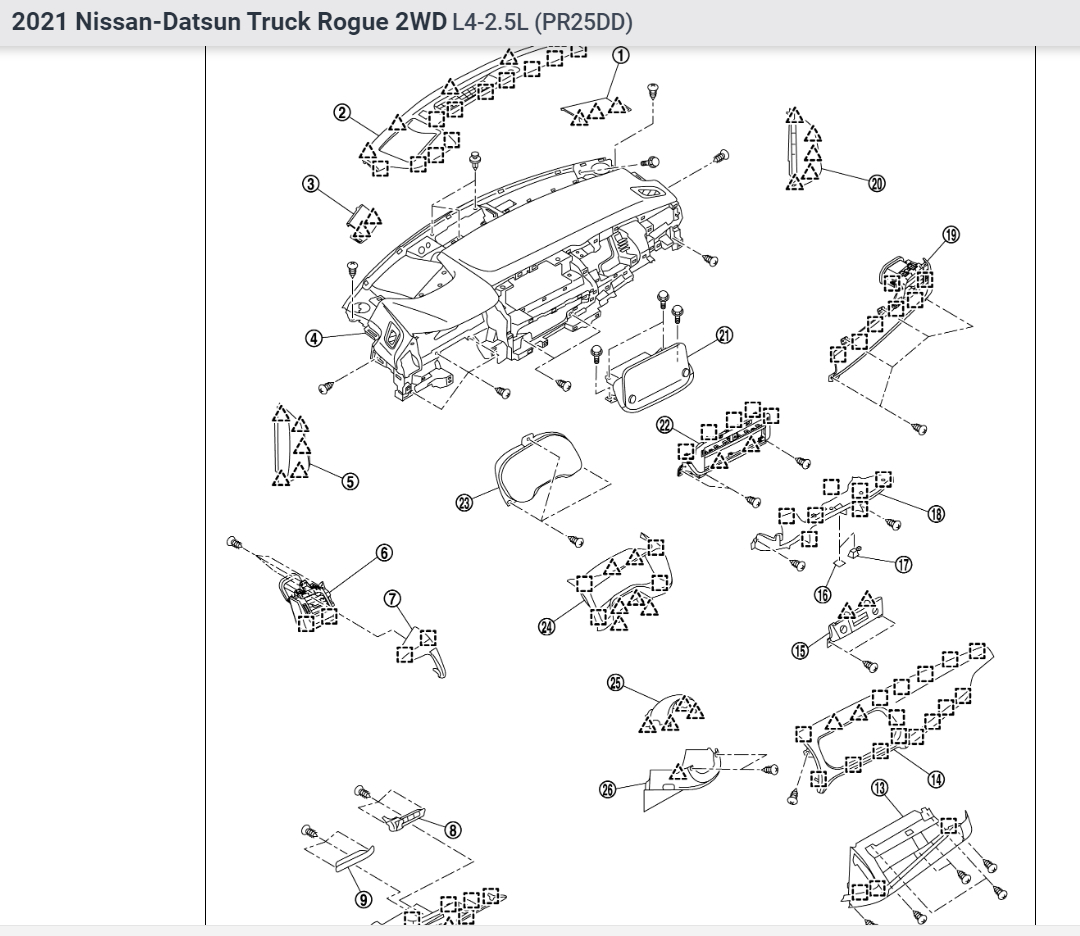

Yep, a little young for having these kinds of problems but what is happening is the voltage amplifier that runs the digital display is going out, that's why it works sometimes but not others. You can get a rebuilt cluster by searching Google or eBay and do the replacement yourself. Here are the instructions on how in the images below. Please let us know what happens.
