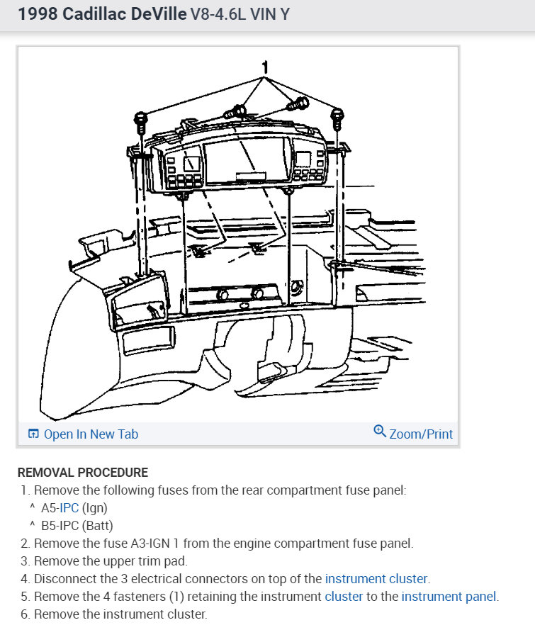

The center cluster on the digital display just stopped working. No flickering or warnings. Just after sitting for a month, started the car and no center display. The two smaller displays on either side with fuel, range, and climate control work, and so does the display on/off switch.
Jun 29, 2019 at 1:35 PM
This is common when the cluster goes out and needs to be rebuilt. here is a video that shows the job being done on a similar car with diagrams below to show you on your car. We should check the fuses before you begin though.
