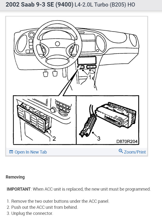

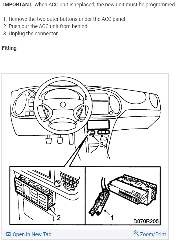

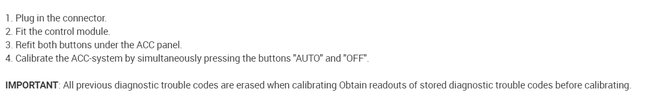

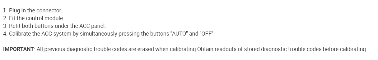

The new unit must be reprogrammed here is the instruction in the diagrams below to help you fix the issue.
Calibrate the ACC-system by simultaneously pressing the buttons "AUTO" and "OFF".

The unit will produce heat upon resetting by pressing auto and off button at the same time. The problem starts when I try to adjust the temp using the blue and red arrows. ,
It produces heat for about a few minutes and then cold air starts blowing.Even upon trying to set the temperature on high using the arrow the unit will not heat. Until I reset the unit from the beginning, I have no heat. What do you think I should do?
