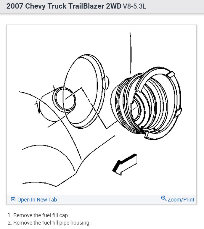

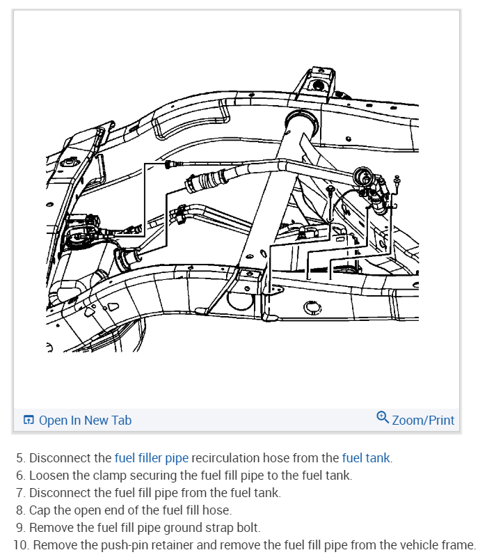

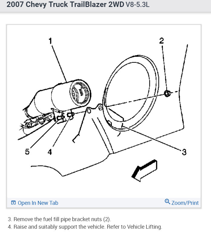

When pumping gas at the gas pump it takes a really long time as it is constantly clicking/shutting off.
The gas does not spill out or anything it just constantly clicks off.
I already did the following:
- Replaced the purge and vent solenoids
- Replaced gas cap
- Replaced the charcoal canister
- Disconnected all the vent/EVAP lines and blew compressed air. Confirmed that none of the lines are clogged (air comes in and out normally). Including at the filler neck.
- Confirmed filler neck hose is not clogged or bent.
- Confirmed vent at filler neck is not clogged.
- I can also hear the compressed air entering the gas tank unrestricted.
After I disconnected the lines, blew compressed air through all of them.
I went to the gas pump and could pump gas normally for a certain period of time then it started clicking again. Problem then came back full-time.
It seems the vapors are not being purged properly.
I have a check engine light EVAP code that comes up PO466 from time to time (I am not sure if it is related at all as this code has come up in the past but I did not have issues at the gas pump).
I am going to perform some more tests on the (brand new) purge and vent solenoids to make sure they work.
Other than that, what could the problem be?
Could the gas pump issue be related to the fuel tank pressure sensor, or some electrical issue (I do not see a fuse for the EVAP system).
And my OBD scanner is limited when it comes to checking live data.
Please help. Thank you
