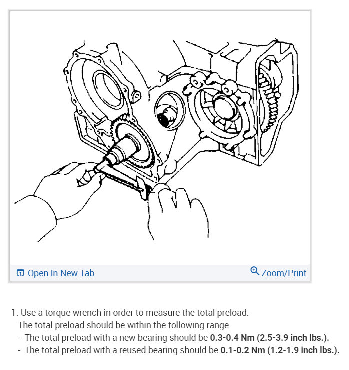

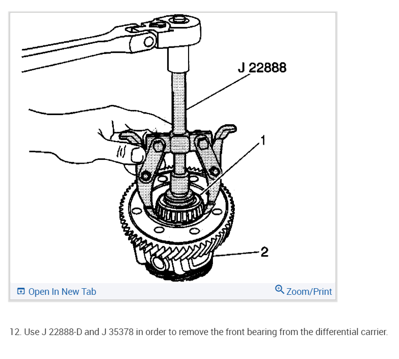

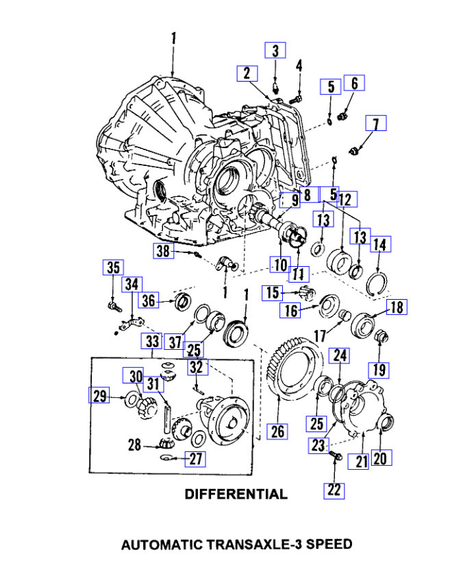

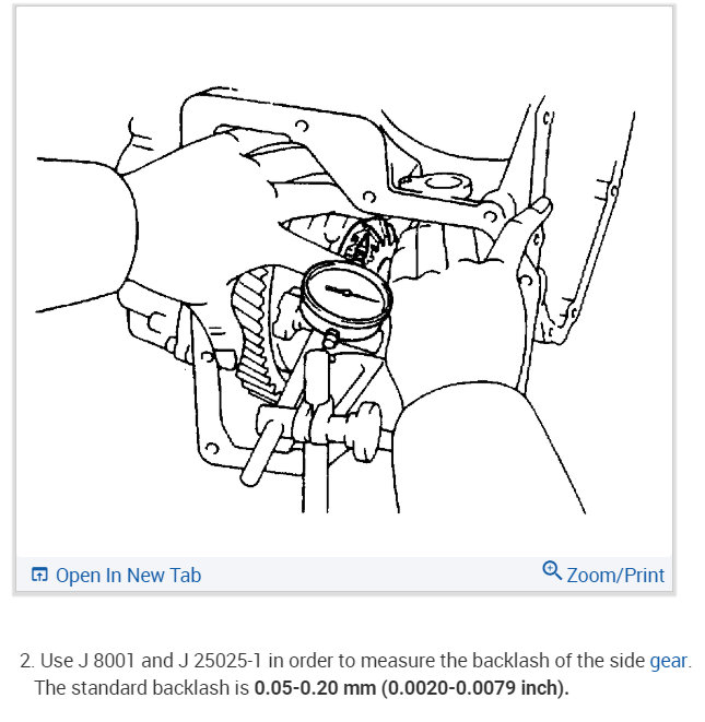

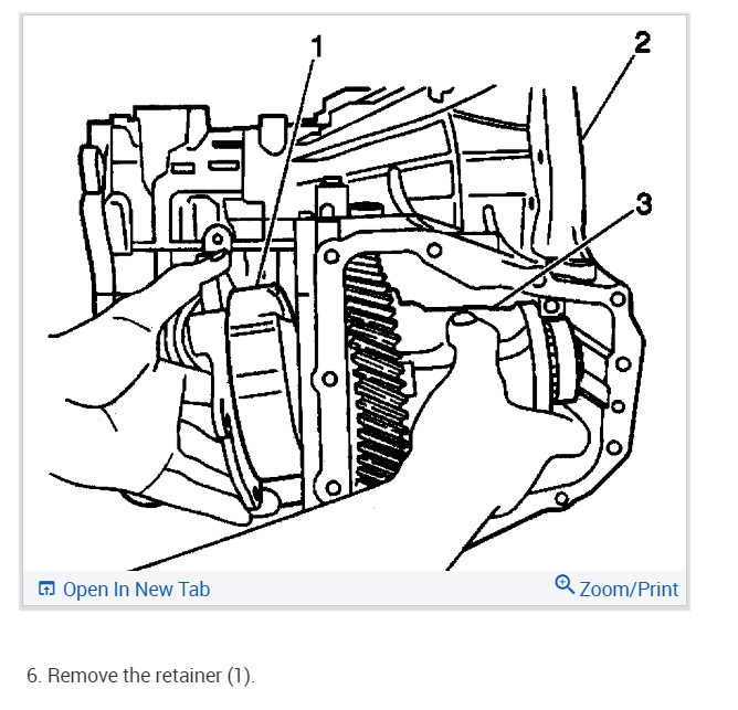

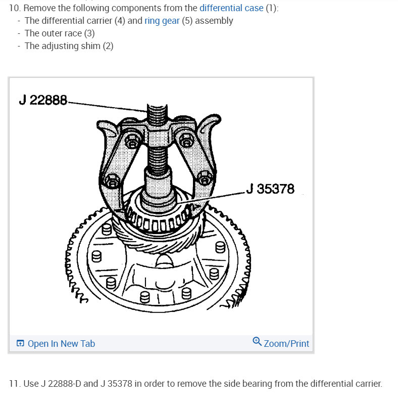

Slack in the output shaft or bearing, beginning to whine, Need procedure for removal and rebuild as well as any sources you may have for parts.
I'm sure i don't have to remind you it is the same as a Toyota Corolla I may not have the engine liters correct.
Oops it is a 3spd Automatic.
Apr 16, 2019 at 5:31 AM

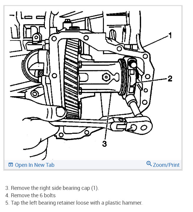

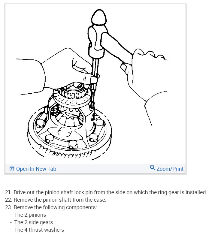

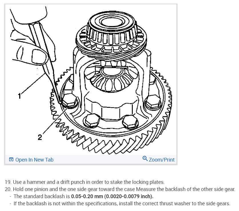

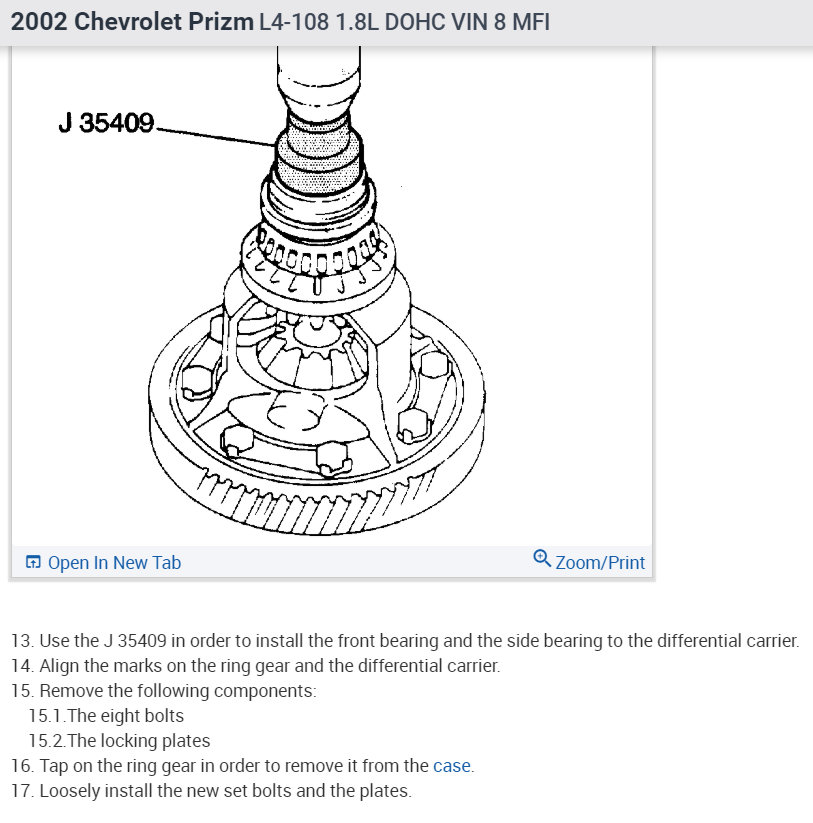

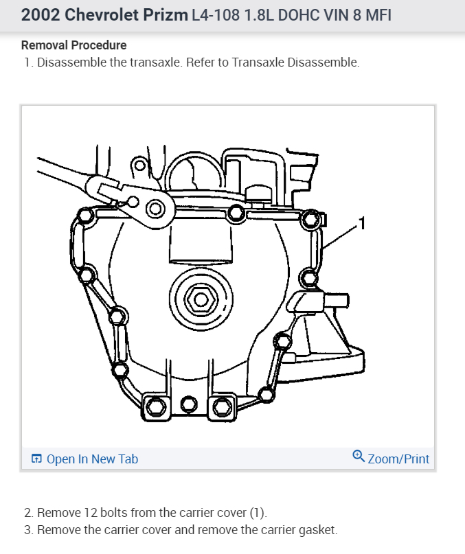

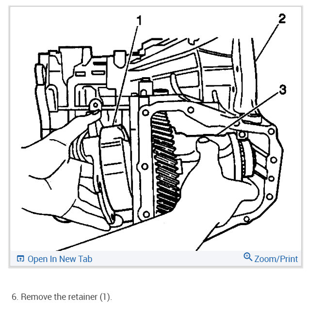

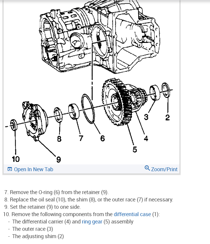

You will need to remove the transmission first. here is a video to help you with that on a similar car. I have included transmission and differential rebuild instructions and diagrams below.
https://youtu.be/6N6b5F2ChyE
