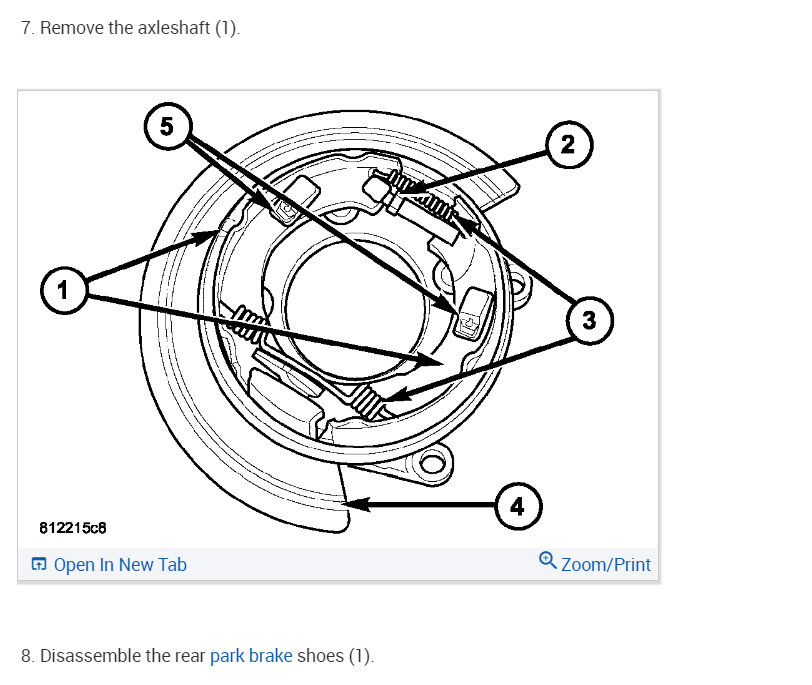

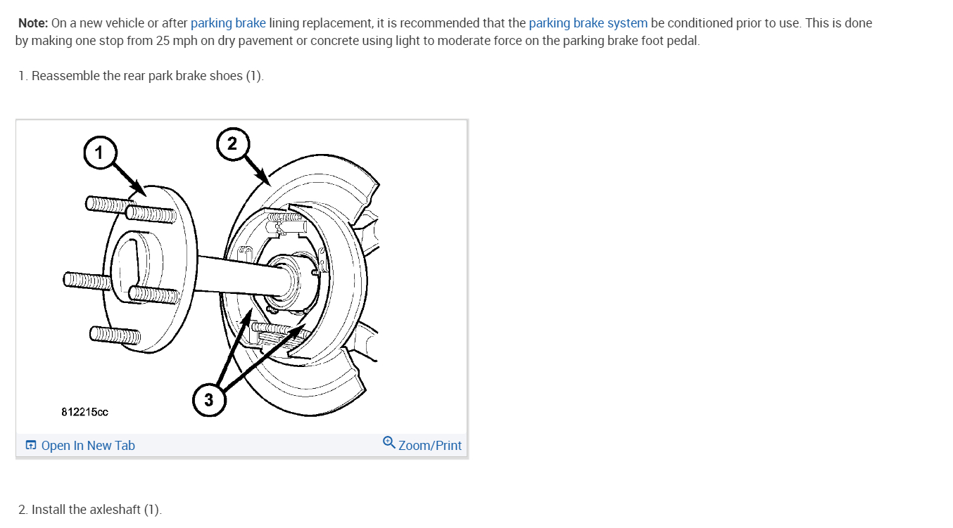

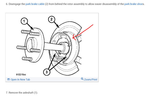

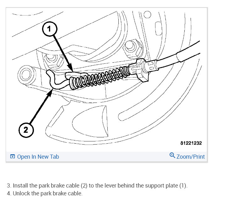

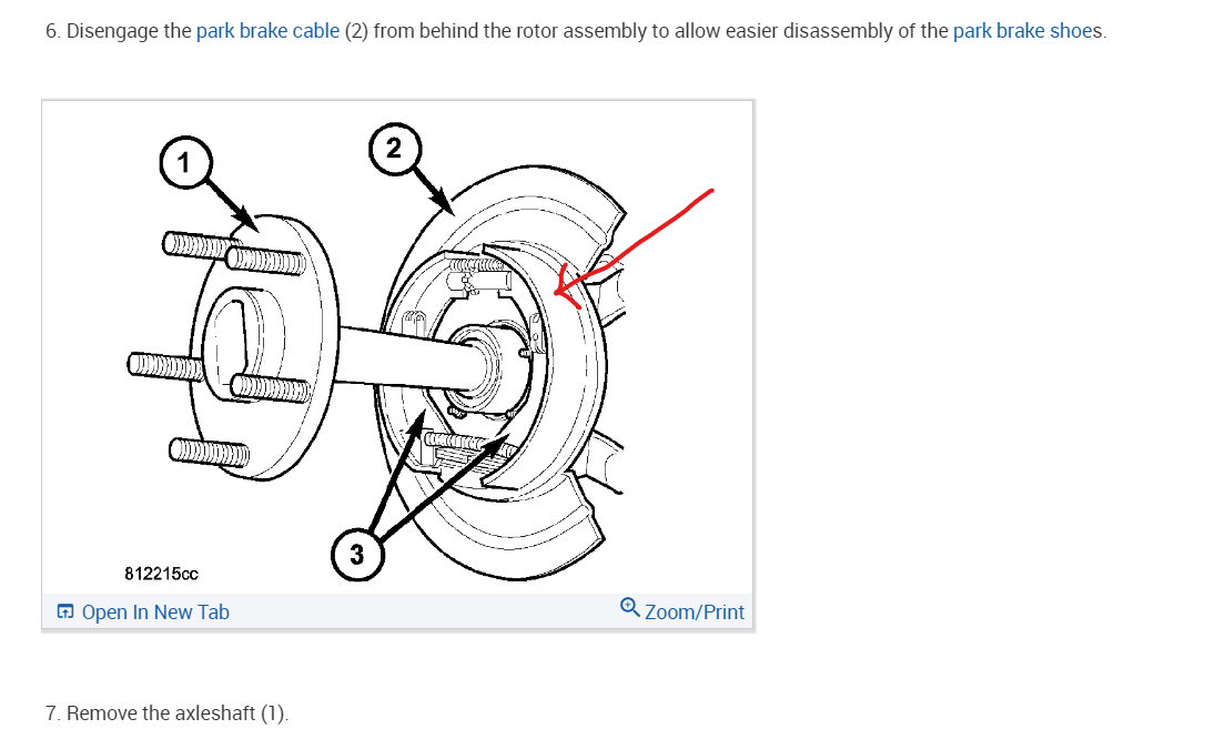

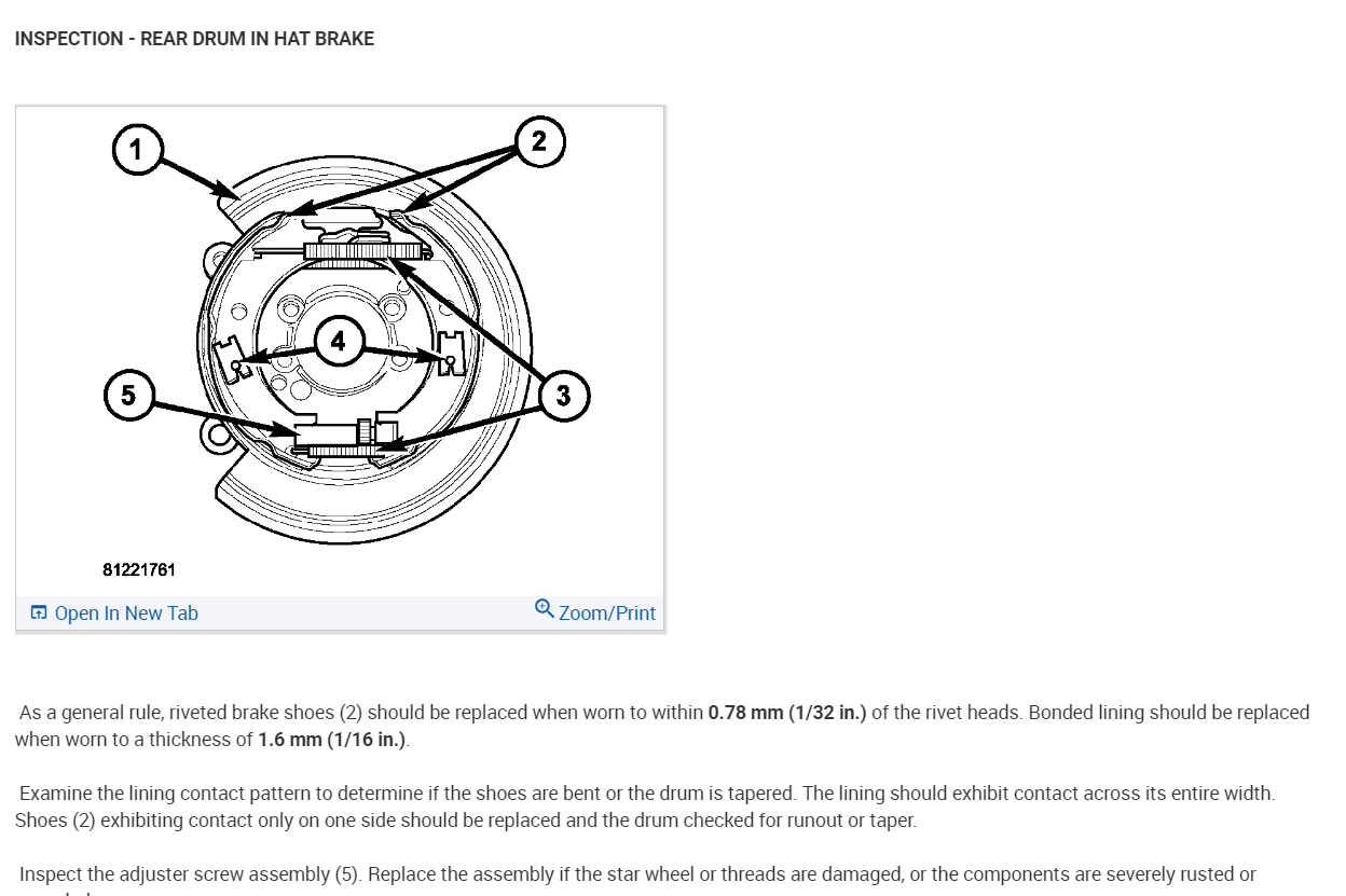

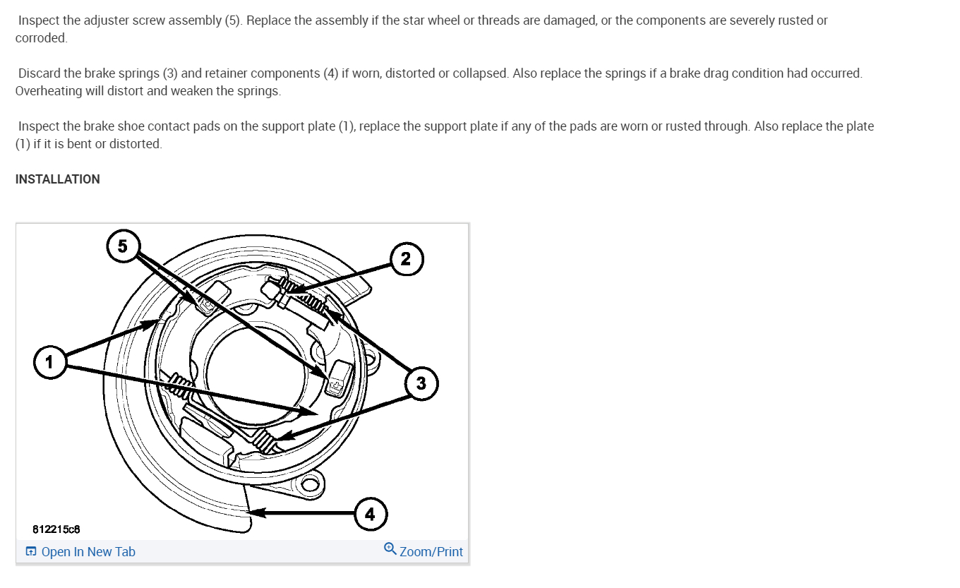

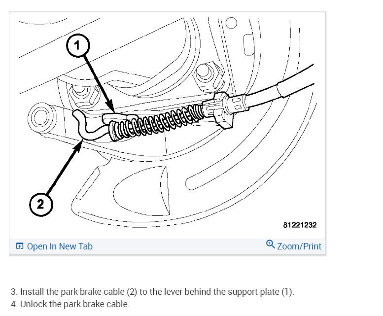

Thanks for the video, it helps. That sounds definitely like brake noise. Did you check the rear brakes and parking brake shoes as well? Check out the images (below). Please let us know what you find.
Jun 17, 2023 at 9:32 AM
