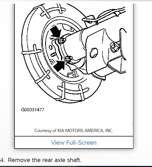

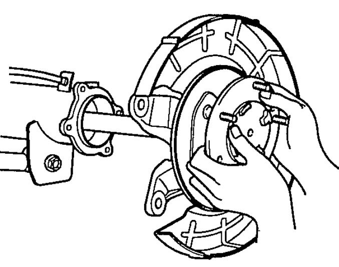

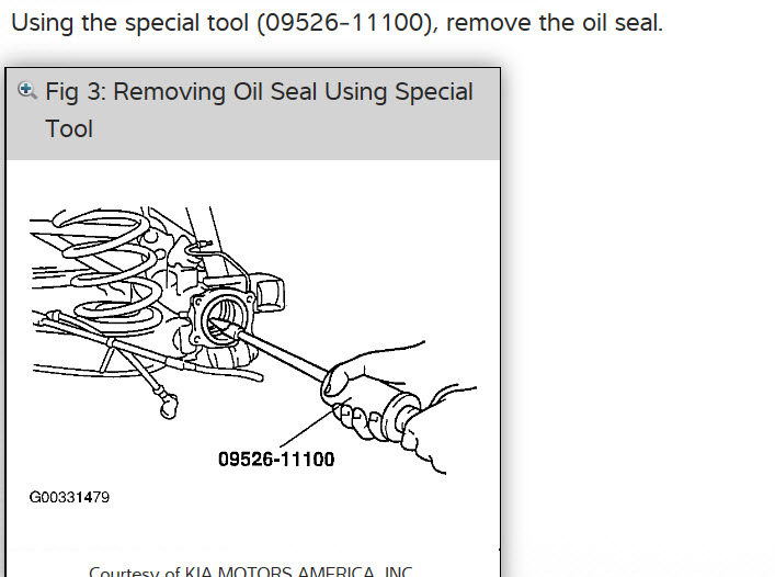

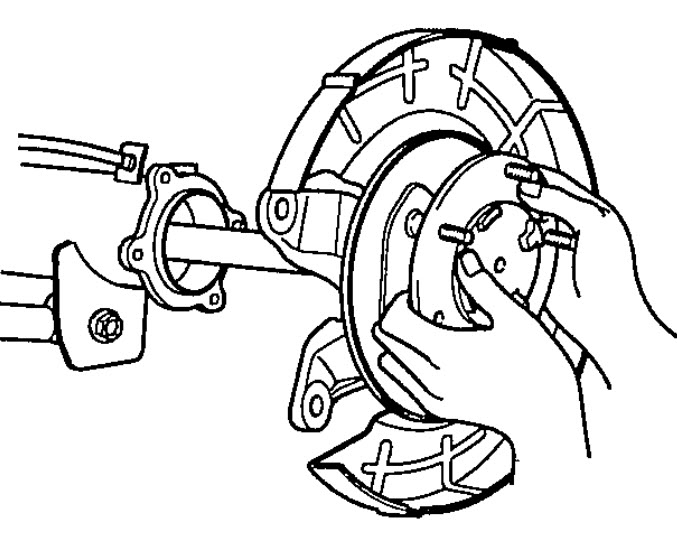

Right rear axle leaking oil between axle housing and disc brake backing plate. Cannot see any oil on pads. But brakes feel mushy.
Jan 14, 2017 at 12:12 PM
HMAC300
CERTIFIED EXPERT
48,601 POSTS
the pads may be oil soaked from the leak they usually are. so you will have to fix the leak. See pictures.
