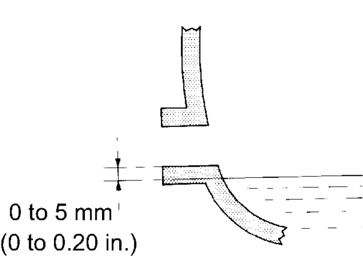

The OE number is 3.5 quarts for full, but normally the better method is to remove the fill plug and check the level there. Full is level with the hole to 5mm below. I generally check it cold because the oil will expand as it warms up, so if you check it warm you may have some leaking out if it was up to the plug cold.

Okay, maybe since i let it drain longer i got more out. I placed my finger right there cold and it was very close to hole. Is there an issue if it took almost 4 or if it's a tad higher than on graph?

75-90 will be okay, they call for 80-90 for ones that may be operated in the cold so the 75-90 will be fine. As long as the truck was level when you checked it you should be okay. LS additive won't hurt if it doesn't use it, just makes it stink more.

The only reason it might go lower would be if it leaks. Driving around the oil will get warmer and expand from the heat, so if you were to check it on a level surface with it cold and it was right at the fill plug, then you checked it after a long trip with it still hot, it would likely leak out a bit due to the expansion. But if you check it cold it would still be level with the plug. As long as the truck was level when you checked it and the oil is at the fill plug it will be fine.
